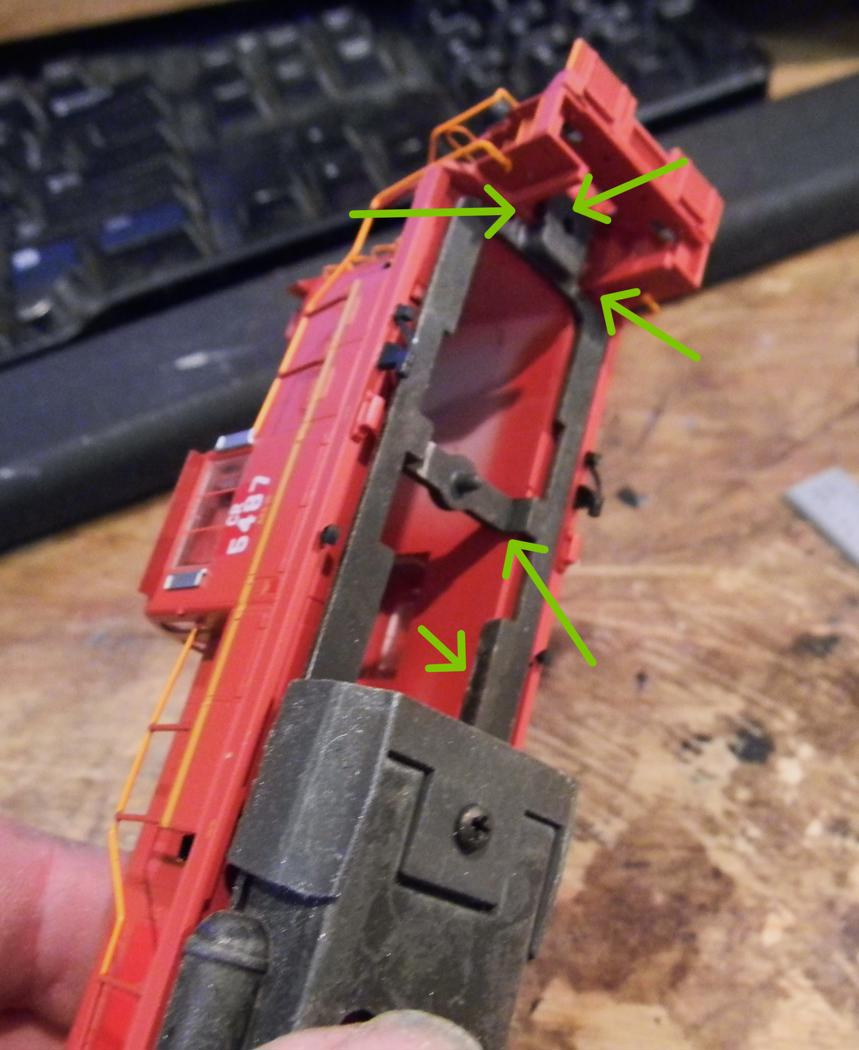

Filing would certainly have worked, but I must confess I've gotten lazy in my later years....  Took the gear towers off to allow more space.  The photo below shows all of the mods (green arrows) I've made to the frame to get a good fit.

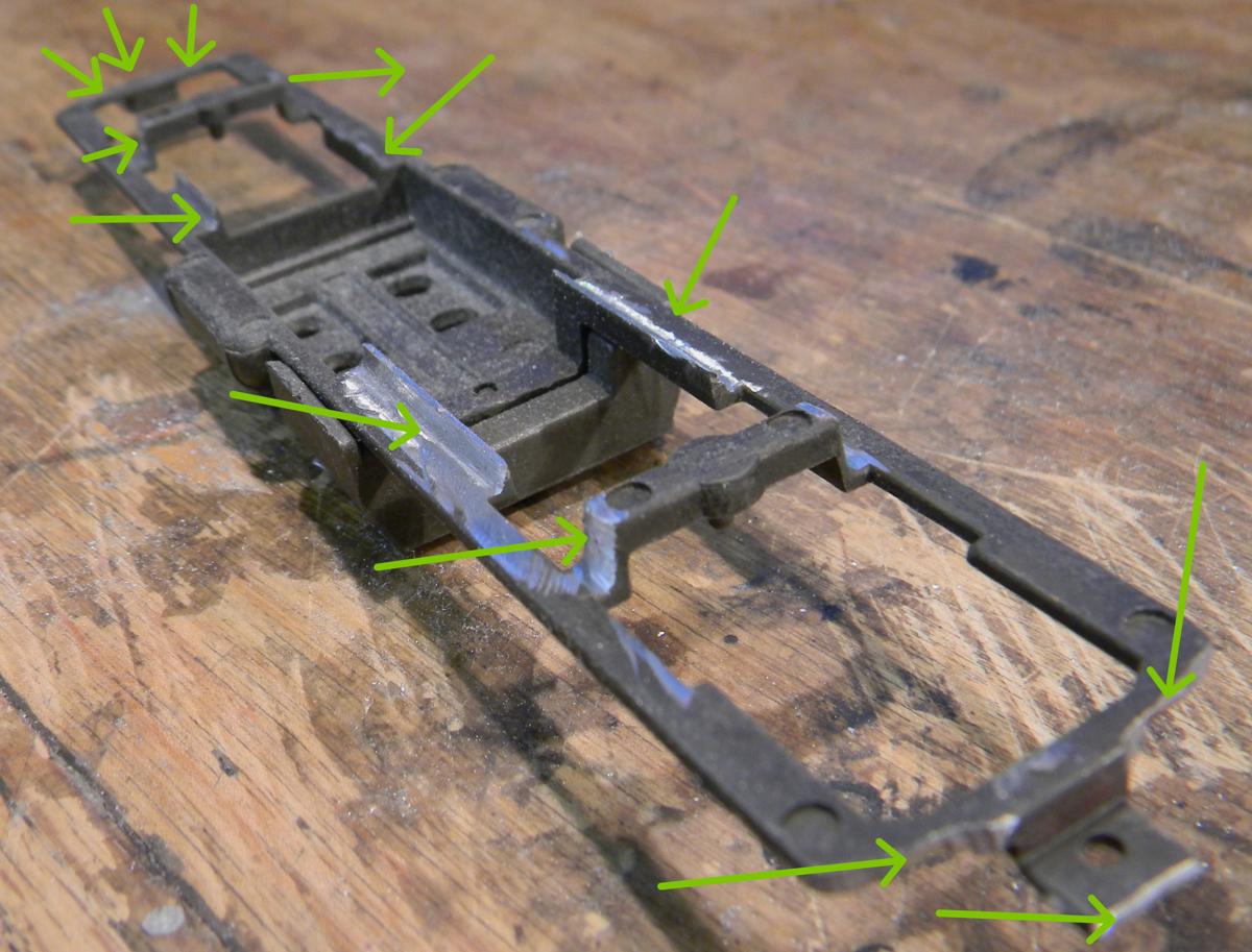

The Dremel with a cutting wheel used carefully with frequent fit checks worked like a charm!  The chassis is now a nice friction fit into the shell. The green arrows in the photo below show where the interference conditions used to exist.

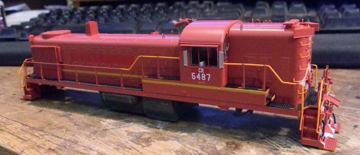

...and here's a side shot with the frame secured in the shell.

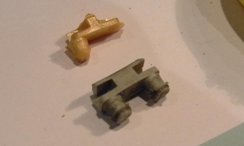

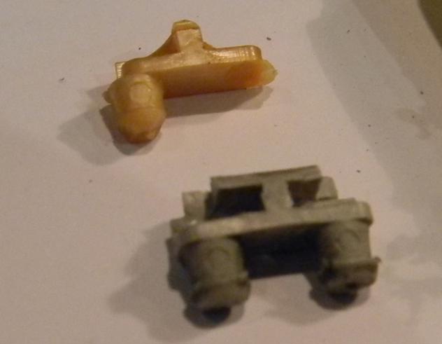

Another update tonight.  The delivered motor mounts were toast...  the plastic was disintegrating.  I had some Athearn rubbery mounts that fit the holes in the chassis, BUT needed to be modified to fit the Roundhouse motor.  There are two pics below of a portion of the old mount and the Athearn mount before and after mod (accomplished with a sharp knife carefully applied):

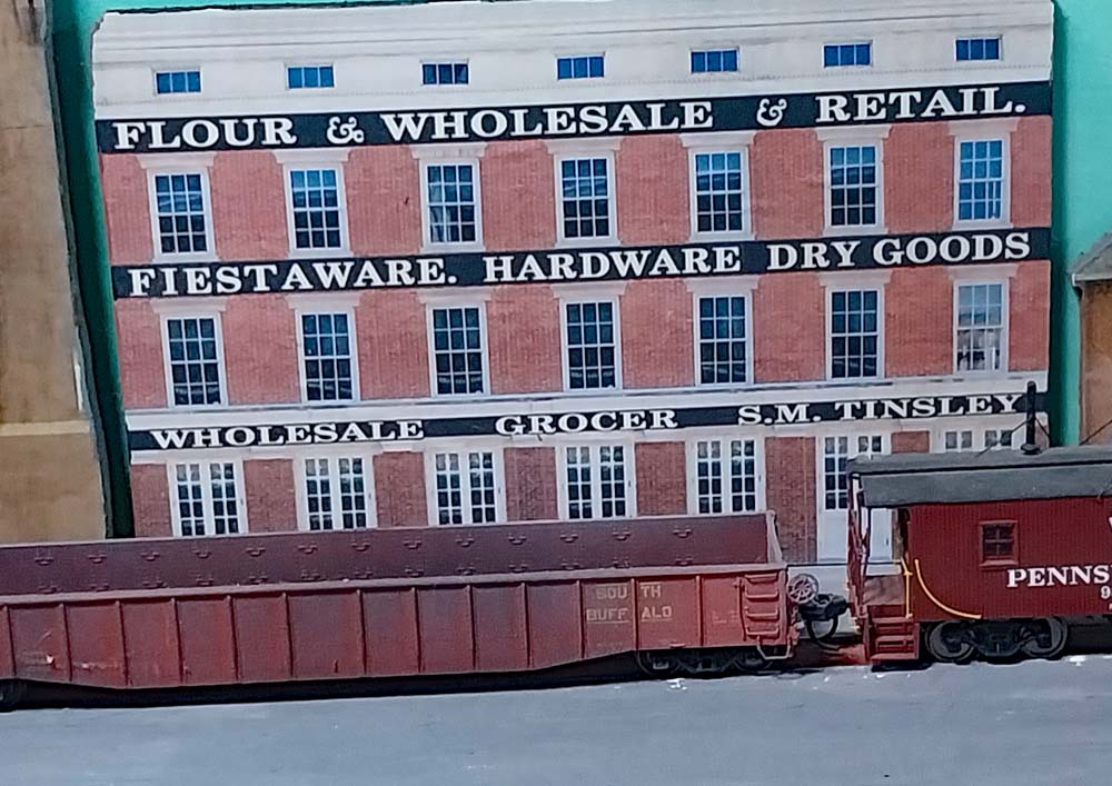

This doesn't qualify as a "purchase" per se, but I did decide to download another of the Illinois Historic Preservation Agency buildings.  I think with some slight modifications the Tinsley building would fit into White Haven, and I downloaded the .pdf file this afternoon.  Might be a while before I begin construction however...
Tinsley Building - Preservation
I thought that was familiar. I just modified the front to fit with my hometown which produces Fiestaware.
It made an easy backdrop building.
Yes! That's the one. The gaudy advertising might have to go, but I may also alter it - kicking that around as well as the size and roofline. Good to see it on the Wilderson!
