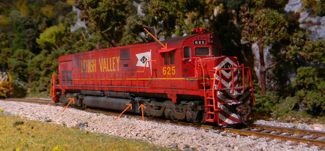

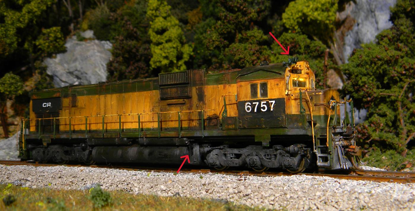

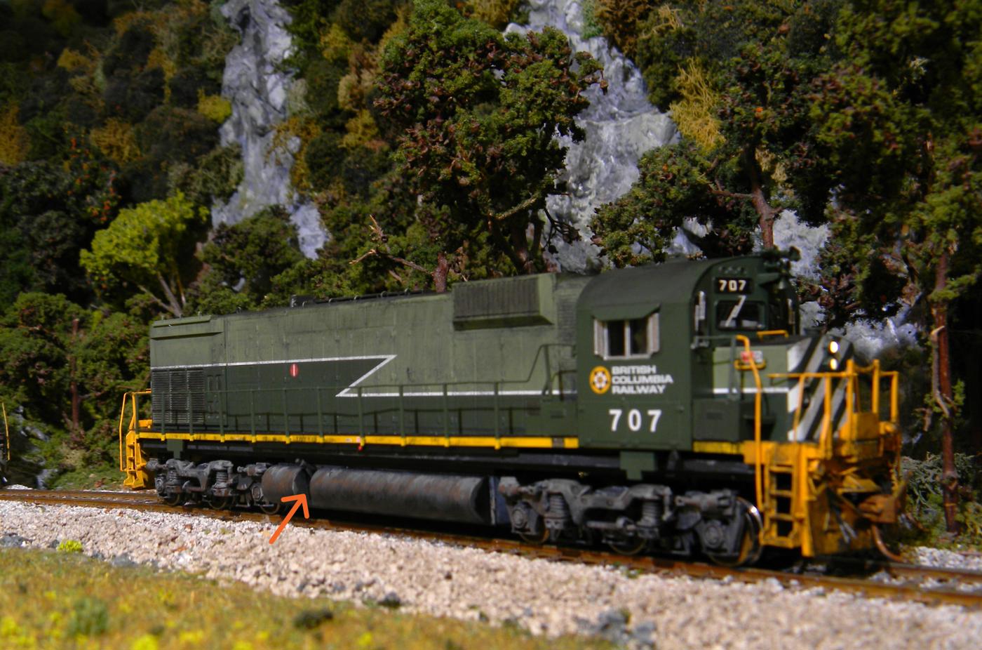

While I watched football this afternoon I decided to break out the detail parts for my Alco fleet.  The primary targets were my two D&H RS-36's and their big brother, a C628, but while I was at it, I remembered I needed a few detail parts for my M630, my C630, and my LV C628...  Fuel filler necks for all three of those on both sides, a horn bracket and a set of horns for the C630.  Some of these are replacements - it's the small parts that end up in wierd places on the layout during operations.  While I was working on all three of those, I did a bit of repair on the brake cylinders on the LV C628.  Then I remembered that I wanted to put window awnings on the cab, and then as I looked at the photo, I remembered that I also wanted to put MU hose clusters on and those awnings need to be weathered a bit...  have to wait a couple of days. I also added a horn bracket and horn to the D&H.  Here's "finished" pics of each:

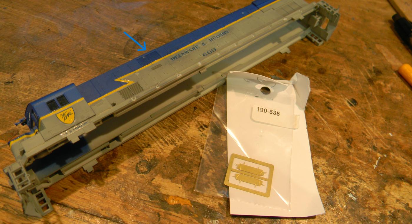

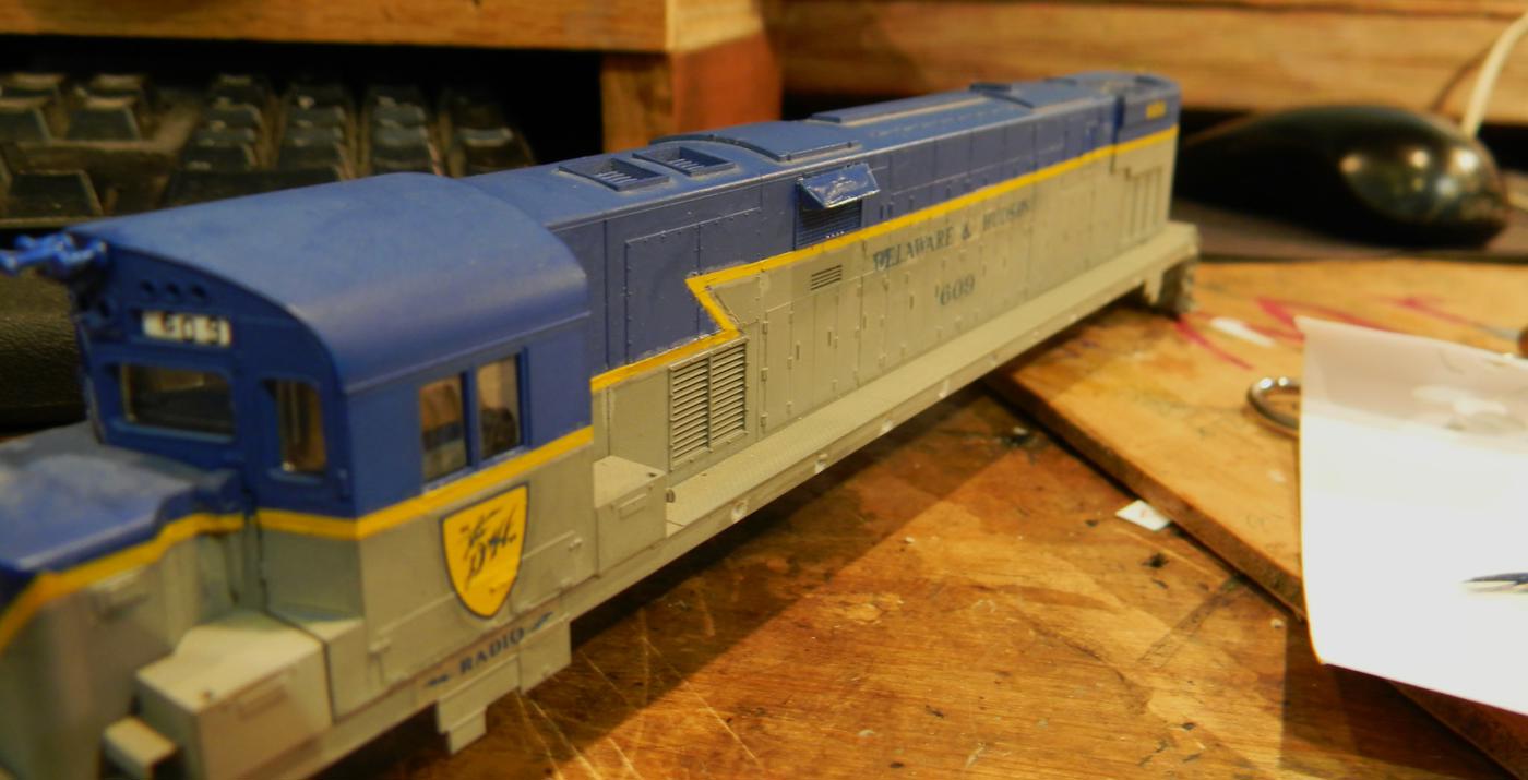

Next on the detail parts install were some rain shields over the intake grills of my D&H C628.  Most of the early models in the D&H fleet had these 1116.1343123837.jpg (1200×819).  Cal Scale makes a brass set of two (part number 190-538).  They fold up on the two sides and they provide 4 brass mounting pins to secure into the shell.  I'll hit it with a couple more coats of paint before I get to the one on the other side of the loco.
