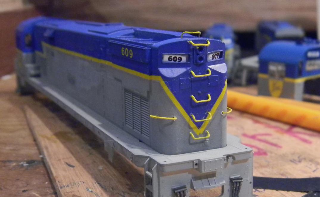

Made some progress on the D&H Alco fleet.  My rear window glass in the C628 took some heat at some point and deformed.  I had an extra set for the front which wasn't exactly the same size, but I got it close and applied some "sticker" number boards.  Also installed the corner grabs (Cal Scale 190-516) on the loco and removed the "Delaware and Hudson" decals on the long hood since I want to redo them.
Installed corner grabs on the RS36 units as well (Cal Scale 190-529) and did a little retouching of the paint on them - I like the yellow even though it's not exactly prototypical.  The grabs were generally the same color as the hood in the same area, but I did see a photo with yellow grabs on a restored unit, and like the look.

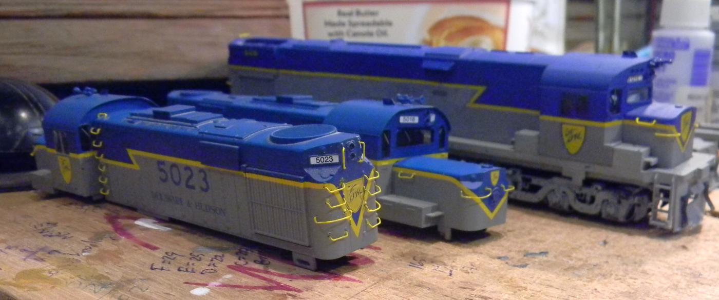

Gotta move on to coupler release bars next, windshield wipers after that.  Getting closer to the end of these detail additions and the prospect of weathering these.
The RS-36's are ready for weathering.  The C628 still needs some windshield wipers, but it's almost ready.
In summary:  New grab irons all the way around both locos.  New lift rings over the engine bays, new coupler release bars front and rear, new antennas, new M/U hoses, new yellow paint on the grabs.  Definitely a better presentation than right out of the Atlas box.  They will soon be a bit more distressed...
