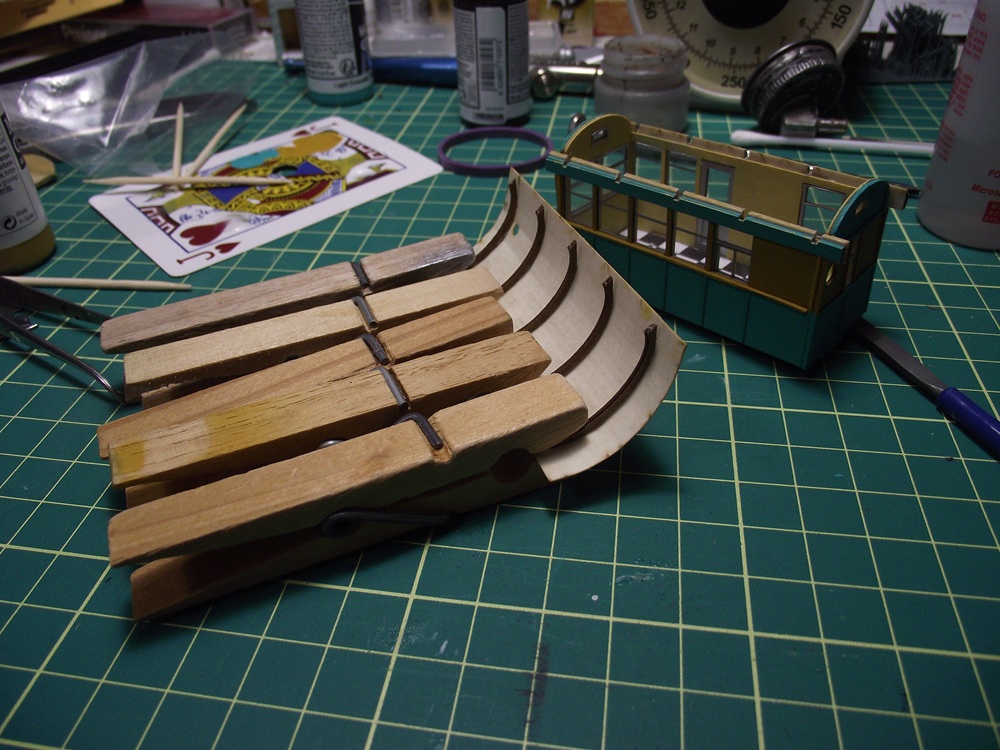

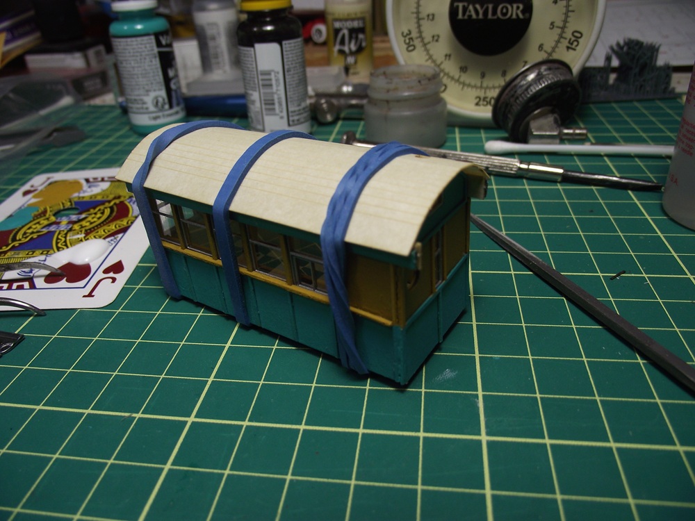

There are 5 rafters that are built up and slipped into the slots at the top of the side walls. If you want the roof to be removeable, you don't glue them in.
Then I took the roof panel and rolled the curve into it. I used a Vallejo paint bottle to shape the panel. I then glued it to the rafters and wraped some rubber bands around it to keep it's shape while the glue dried.
I then added a bit of glue to the ends of the rafters and glued the roof panel down, using some cloths pins to hold it down.

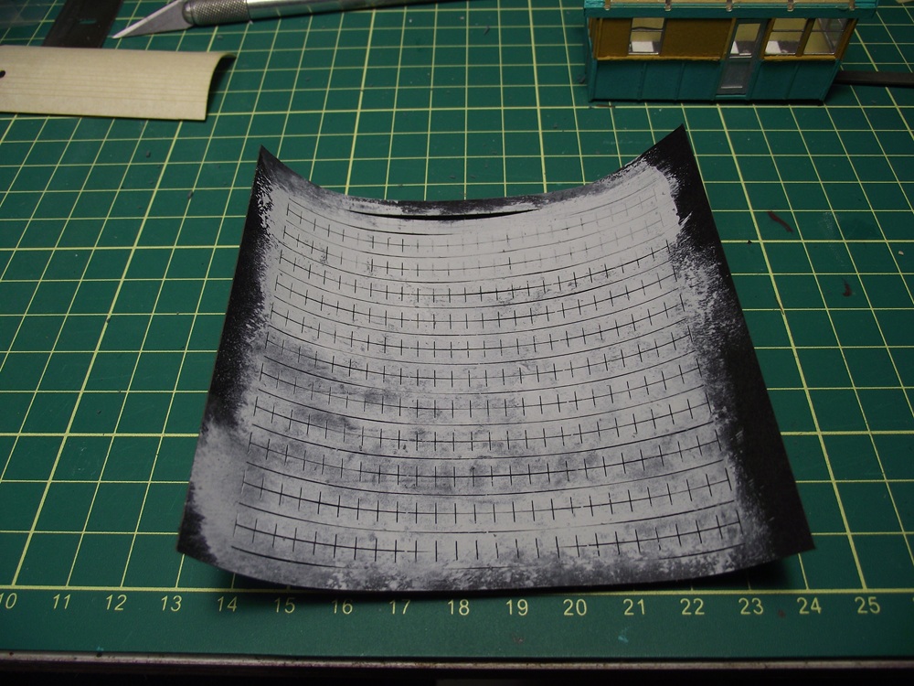

The shingles are laser cut on black paper. I sponge painted them with a light gray.

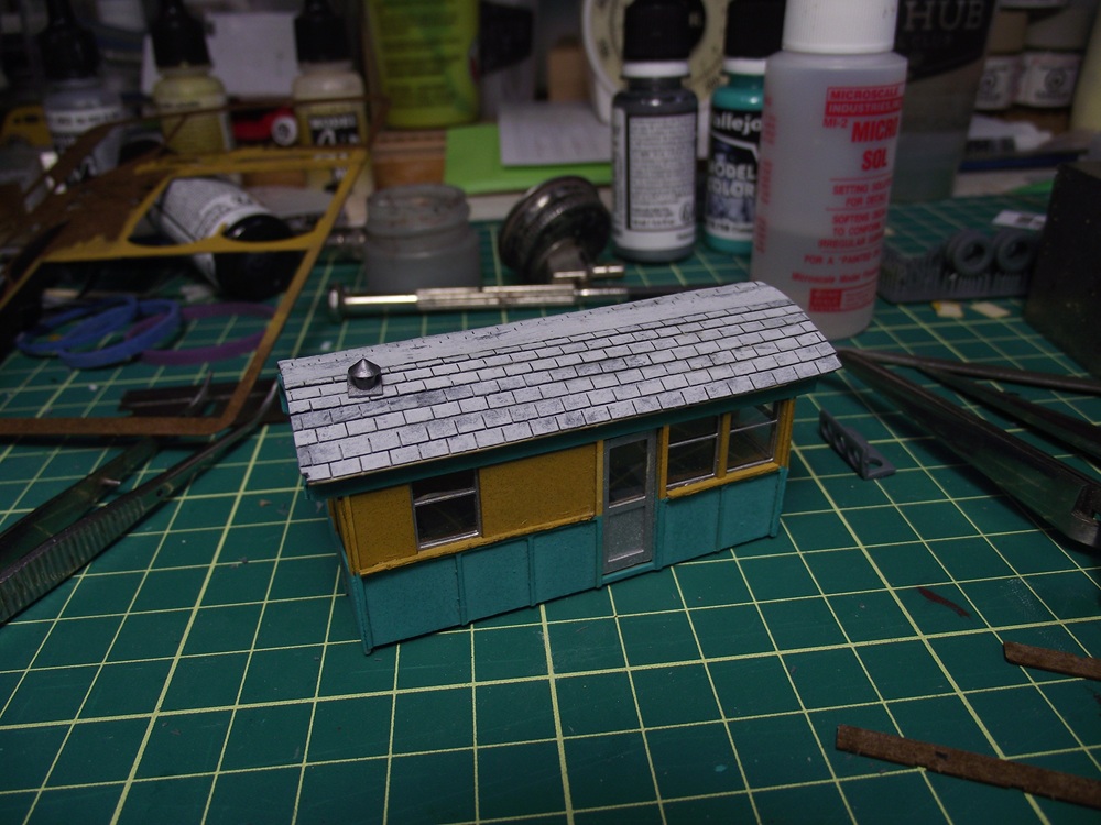

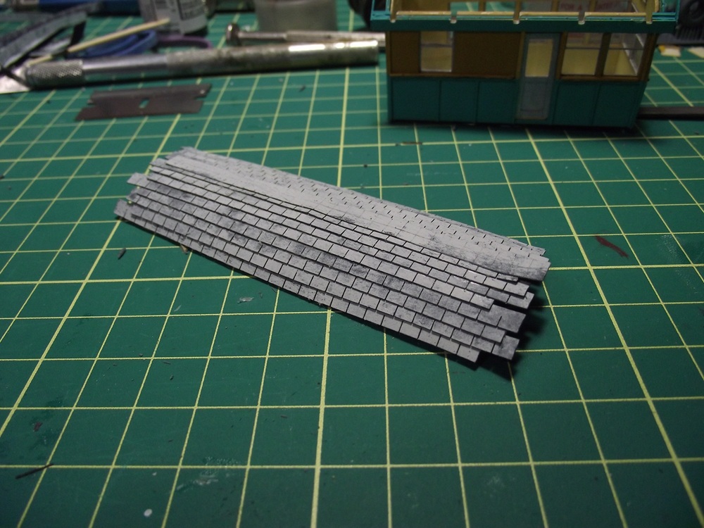

I shingled the roof just like any other kit. Usually I use Scotch douber sided tape to glue the shingles down, this time I used some white glue. It's a small roof to it only took about 30 minutes to do all the shingles.
I then trimmed the shingles to the edges and then added the the small smoke jack. The structure is done so now I can get working on the interior.

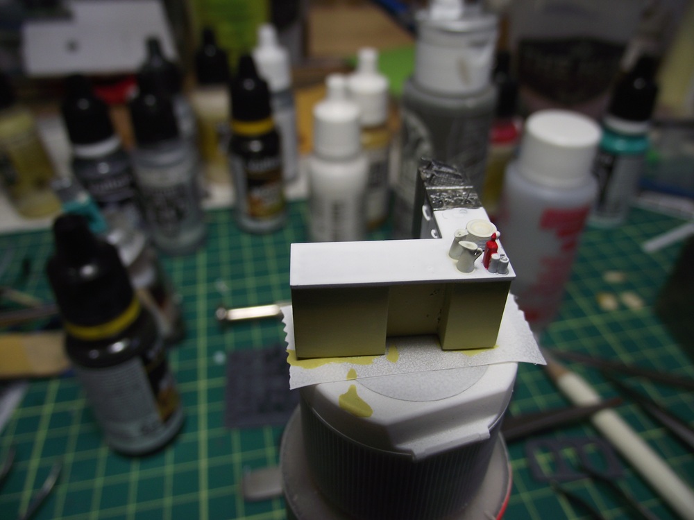

 I started with the front counter and fryers. I airbrushed everything white and then detail painted. On the counter are a stack of plates, napkin holder and a ketchup bottle.
On the backside of the counter are the deep fryers and burners. I painted them in a stainless steel finish.

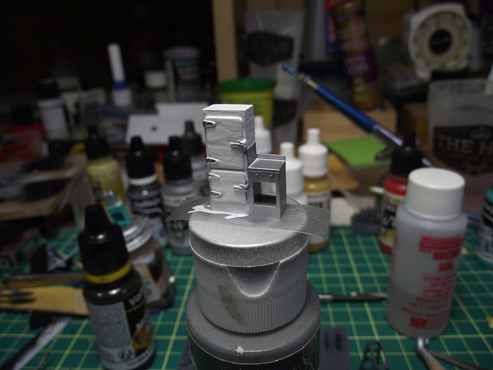

Next was the refridgerator/freezer and the fryer.
