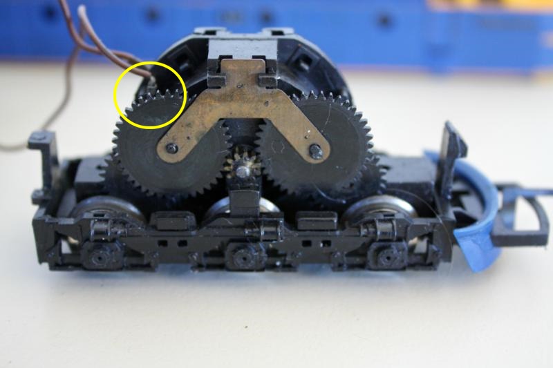

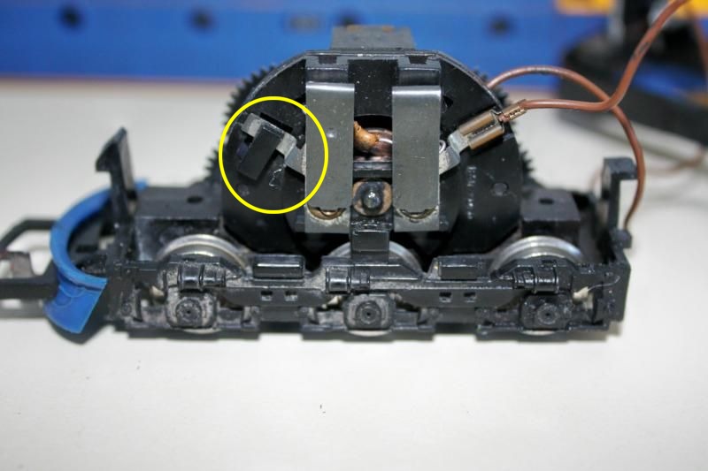

[Image: img_0311.jpg]
[Image: img_0315.jpg]
[Image: img_0313.jpg]
Is this motor suitable to hardwire a simple or even a sound decoder to.

With the motored truck removed, and all wires disconnected between it and the chassis, take an ohm meter and test continuity between the wheels on the power truck - if there is, the motor is hardwired to the truck and may be difficult to isolate. Or, take the disconnected truck and put it on the track and see if it will go. If it will run - the motor is hardwired tot he truck and may be difficult to isolate.
Being that this is a "pancake motor" chassis, it would be difficult to simply remotor with a can motor. Your easiest option may be to find a chassis with the same wheelbase, and put the shell atop that.
Jack:
since one of the motor brushes (on the left) doesn't have a visible wire to it, I think it is probably hardwired to the track. You would need to find a way to break this connection. These motors are probably the hardest to chip after the ones that are completely enclosed in a chassis.
Sorry, but I have no positive suggestions.
There is a very good DCC section on <!-- m --><a class="postlink" href="Http://www.RMweb.co.uk">Http://www.RMweb.co.uk</a><!-- m --> sponsored by Bromsgrove Models who are experts, together with a lot of guys with considerable knowledge, who will be able to help. I'd suggest you join and ask on there - particularly since this is a Hornby/Lima model with the old "pancake" motor. You should also be able to get advice about re-motoring it - explain that you aren't in UK. Best of luck
Shortliner(Jack) away up here in the Highlands
PS - Mods - I trust I haven't broken any rules by posting a link to another forum (I know some forums don't allow it) - If I have I apologise!
I believe David is correct, the motor housing is probably in contact with the rail on that side.
That said, all you should need to do is isolate that brush from the frame. Some dielectric tape or heat shrink around that clip (or removing the clip entirely) should do the trick, assuming there are no other electrical connections between the rail/chassis/motor.
Actually, after looking more closely at the motor (and the backside) it looks like it may not be connected to the track. It may be that the lead from the rear truck may just be soldered to the frame of the motor rather than the brush itself. If that's the case, and the motor housing is isolated, it's a piece of cake.
Wow what a fast response team,
Nachoman, Shortliner, BR60103 and Squidbait, thank you for all the help, a very knowledgeable crew we have here, and I guess if I had half a brain I would have seen what you have pointed out to me.
I can now see In this picture, that the motor drives the front truck ...... but is powered by the two leads from the pickup on the back truck . 35 So I would assume as squidbait says that the motor is isolated from the track.
