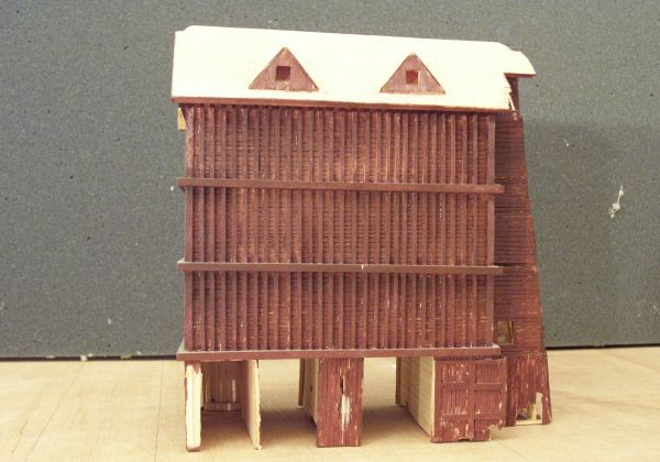

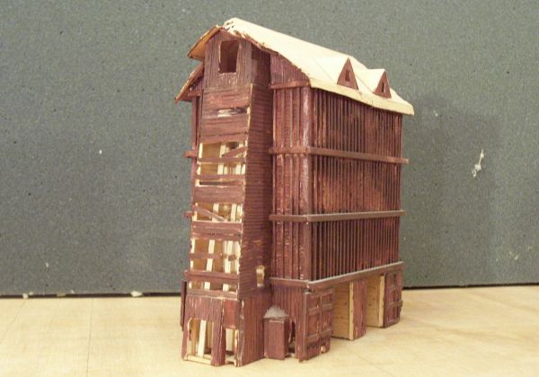

Bob, I know I'm closing the windows after the big rain, but this coal tower used to serve the residents of Lindenhurst, L.I., N.Y.. I built this out of balsa, and had gotten to this point when the building was demolished. I modeled it pretty much exactly the way it looked at the time.
Coal was dumped in an under track pit, hoisted to the top of the building with a bucket hoist (the enclosure on the end), and loaded into trucks inside the two drivethrough openings. We'd get the coal dumped on a chute through the basement window. We'd then have to move it to an area near the furnace.
If you're looking for a project some time down the road, here's a possibility.....

Good looking coal tower too Pete.

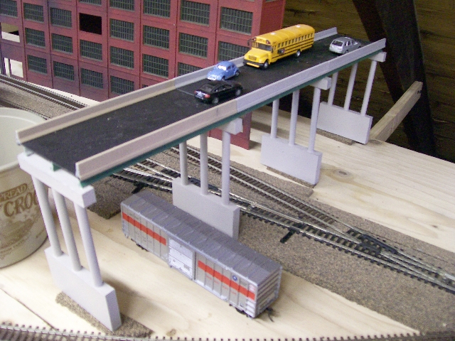

I have the modern bridge from Rix. If I knew the "older" one looked good I would of picked it up. I might still get one just to add some variety. As you can see, I under estimated the length. And I think it might be too high. Looks spindly at that height.

How long is that overpass 88 ?

Nick-the overpass sections are approx 50' long. I needed 4 for my layout.
88-I had the same problem when I did mine.As I mentioned above,I managed to shorten mine. I have the same piers. Measure from the top of the rail to the bottom of the overpass beam to get the height you want.What I ended up doing was to cut the top part of the pier off,figure how much you need to remove and cut the posts to the new length,then re-cement to upper part. I know it sounds confusing but not really. Look at mine in picture 3 and you may be able to tell what I did. If you need more help let me know. Bob

Thanks for the suggestion Bob, I was wondering how I was going to lower it.
I'll give it a shot. Let you know how it ends up.
