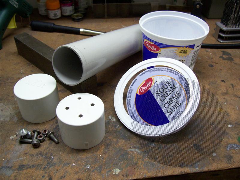

Here are the materials needed:
Clockwise, from upper left - a piece of 1 1/2" plastic pipe, about 8" long (I used a piece of thin-wall PVC that I had on hand, but was unable to get end caps to fit - the ones shown were modified), a 16 ounce plastic container, with lid, similar to the one shown, a piece of aluminum window screen, two suitable caps for the pipe, plus some screws and nuts to fasten the container to one of the pipe caps.

Drill suitable holes and fasten the 16 oz. container to one of the pipe caps, using the screws and nuts.

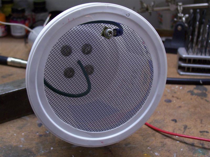

With the knife, carefully remove the centre of the lid, then use your scissors or tin snips to cut the piece of screen to fit inside of the rim of the lid.
I applied some hot glue along the edge of the installed screen, then pressed the glue and screen into place with the tip of a screwdriver.
Fasten the crimp-on lug connector to one end of the #14/16 wire, spread the strands of the screening slightly, then use the small screw and nut to fasten the connector to the inside of the screen, near the edge. Drill a hole for a tight fit on this wire through the bottom of the 16 oz. container and the attached pipe cap, then thread a couple of inches of wire through. Wind the balance of the excess wire around the inside perimeter of the container, then snap the lid in place.
