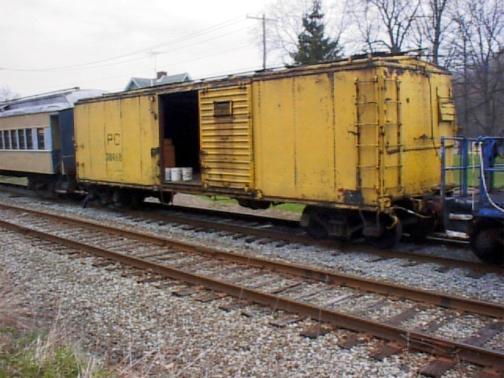

Here's the prototype, an ex-Pennsylvania RR X-29 boxcar, used in express service by REA, and later in MoW service by Penn Central. Like a cat with nine lives, she's still earning her keep as a HEP car for the Kiski Junction's passenger trains.
[Image: X-29boxcar-154.jpg]
The Pennsy's X-29 boxcar has long been one of my favourites, and when my friend Charlie Bowyer, a Pennsy fan himself, announced his intention to retire as Supervisor of Operations for the Kiski Junction RR at the end of this year, I felt that a model of the KJRR's boxcar, returned to its former livery, would make a perfect retirement gift. Another good friend, cn nutbar, was in on this project, too, in the form of funding, so I ended-up making three versions of the car, one for each of us.

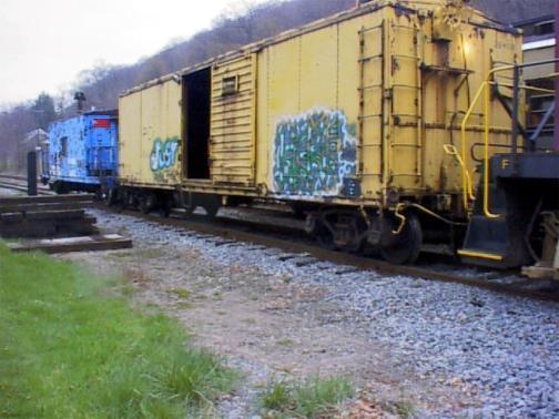

Fortunately, the car's original number was still stencilled on the interior face of the door:
[Image: June2009railroadvacation075.jpg]
The starting point was Red Caboose's version of the X-29 most suitable, the 1924 style, with plate ends, patched side sills, and an REA detail package. (These kits appear to be no longer available.) The prototype car shows BLT. 7-34 on its sidesill, even though the plate ends clearly identify it as a 1924-style car, not the 1928 and later style, which used Dreadnaught-style (ribbed) ends.
