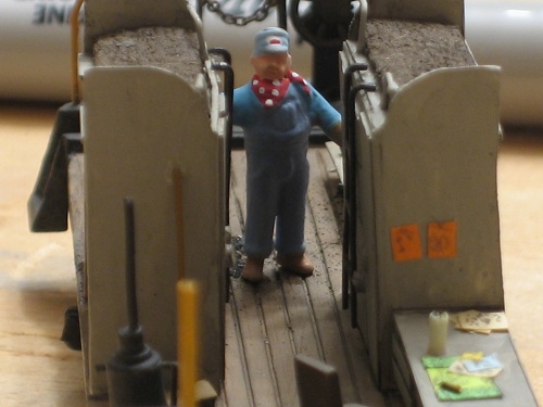

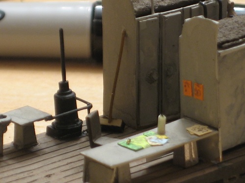

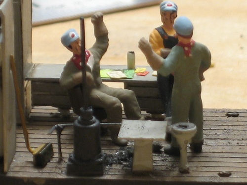

I added some more smaller details, here is #582. The figures are the most obvious, but I've also added a shovel in the coal bin, tools on the bench, and a broom next to the stove.
#64

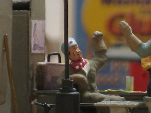

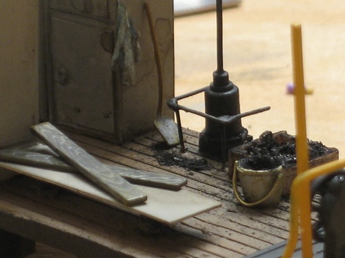

In # 580 We have a coal bucket, some boards and a shovel at one end.
And a meeting of the minds at the other.

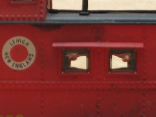

this shot shows how the glazing looks after it drys.

This is O gauge, right?
The details are amazing!
#66
It is amazing how figures bring a scene to life! Great job on the details!
Galen
#67
Very nice work! The details are incredibly well done. Love the meeting of the minds! Looks like one of the guys is telling quite a whopper of a story!

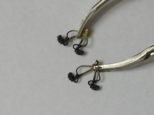

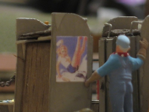

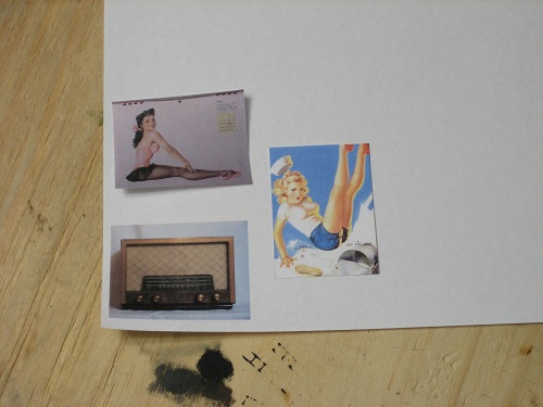

To keep with the 1940's them I just had to add some pin up art and a wooden portable radio. So I did some web searching for some images , reduced them down to HO scale, and gave them a home. For the radio I glued the pic to a piece of strip wood, stained it, and added a handle.
As this was going on the paint shop started on the marker lights. They are the only parts that I purchased for this contest.

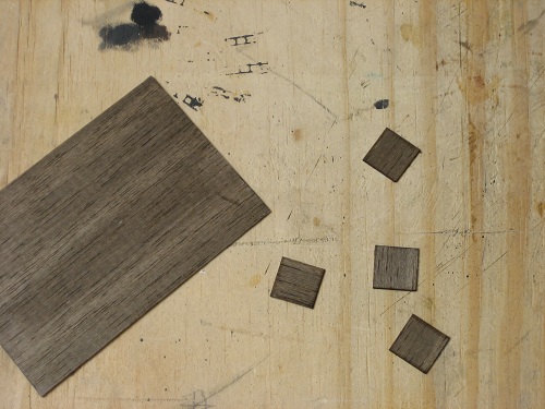

The rear of the bunks was really bugging me, They just looked unfinished. I had some left over wood veneer from the last kit bash challenge, that got cut to size and glued in to fill the back of the bunk to hide the weights.
#69
Here are the pin ups and radio installed. You can also see the rear of the bunks.

Fantastic work again! These additions make it more realistic Cheers

Hmmmmm, That glass, looks like it was designed 25% larger than it needed to be. Big Grin Big Grin
The resolution, on the radio, and the pinups is excellent! I will have to reference your build, when I start interior details for the boathouse kit I'm about to build.
Very nice!!! Thumbsup Thumbsup

Quote:Hmmmmm, That glass, looks like it was designed 25% larger than it needed to be.
No, I'd bet it's the GERN flux additive in the glass itself that just makes it seem 25% larger, and 3% shinier too!
Now...you are going to light the interior of this car so viewers can appreciate all that work, right? Icon_lol

That's some amazing detailing. Internet searches and colour printing are great tools here.
