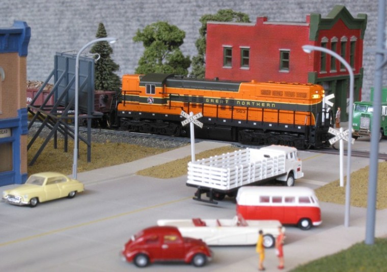

I do something similar to Robert except I use joint compound and dye it with Woodland Scenics Stone Gray...
![[Image: IMG_0656.jpg]](http://i197.photobucket.com/albums/aa145/Ralph59/IMG_0656.jpg)
