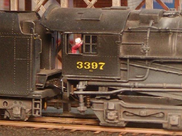

I weather the tracks on my layout. It works for me.
I give one light coat of paint, ballast the track and then weather
everything (Ties and rails). One section at a time with a fine paint brush.
[Image: 20061028154523_T1.jpg]
Your result may vary
Cheers

BTW: The photo examples of the weathered rail looks great. I can't wait to get to that point.
