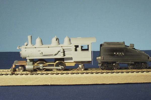

In this picture of my 2-4-2 project, you can see the boiler check valve above the #1 driver. The pipe runs from it back to the cab, to the injector on the fireman's side. There is an identical valve, and injector on the engineer's side.
Also notice that the water pipe to the check valve, makes a 90 degree bend up, into the bottom of the valve.
The lifting injector, has 4 connections. 1. top, steam. 2. front, water to boiler. 3, and 4. bottom, the pipe at the bottom front is the overflow ( and goes straight down almost to the height of the rail head ), the bottom rear, is the water supply from the tender. The upper rear of the injector ( straight back from the water outlet ) is the operating valve.
On the check valve, the small pointy thing,on top, in line with the input pipe, is an adjustment screw, that balances the force of the water, to the boiler pressure. ( it's the inertia of the moving water that actually opens the check valve, the boiler pressure is the same as the steam pressure that gets the water moving )

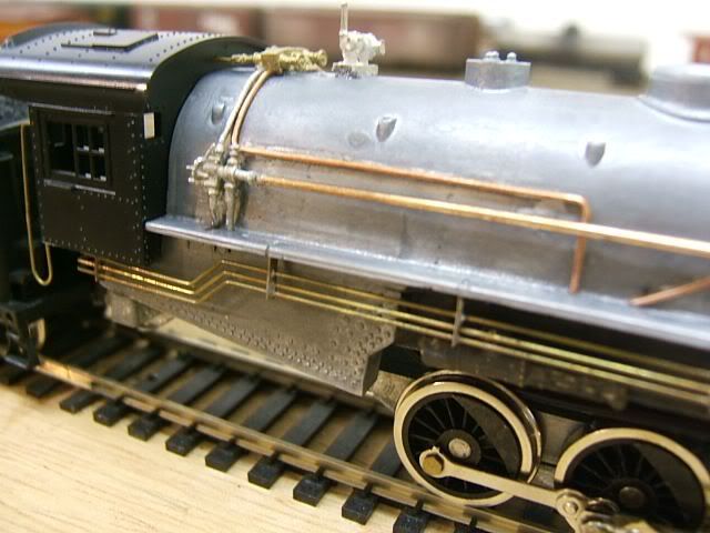

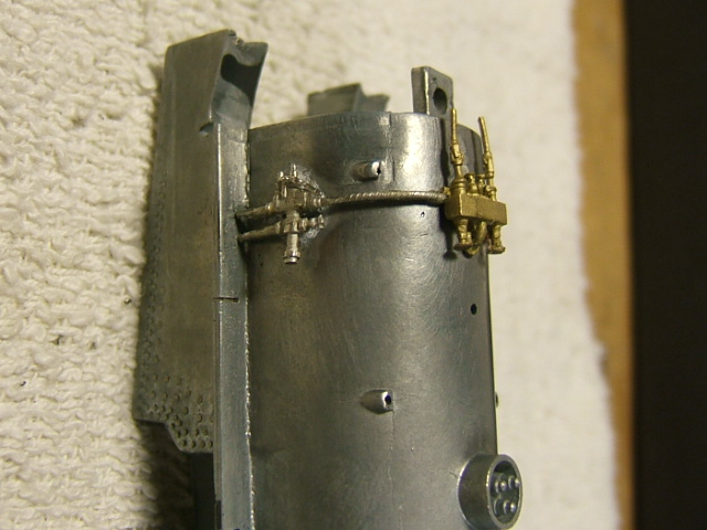

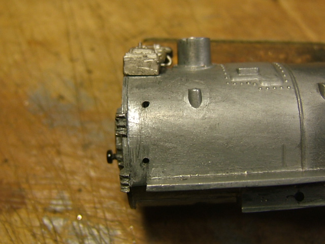

OK....Just to clarify...This is my set-up...
On the fireman's side of boiler
1. CW from tender to CW pump-steam provided to pump from turret
2. CW from pump to FWH (hidden in cladding)
3. HW from FWH to HW pump
4. HW to boiler via top mounted check valve
On Engineer's side...
1. Side mounted injector-steam provided from turret
2. Injector brings CW from tender
3. CW injected to boiler via side mounted check valve
It's this last check valve that is at issue here. As I understand Dr. Wayne's & Sumpter's explanations, the housing opposite the intake hose on the top mounted check valve contains the pressure regulating mechanism...So no water feed possible there. This would be the case as well for the side mounted CV. So aren't the two check valves the same..?? Which was my initial question.... Goldth

#94
A couple of pics to illustrate the above....
Gus (LC&P).

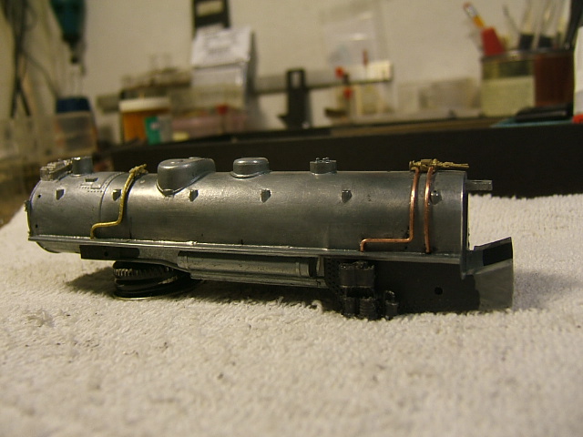

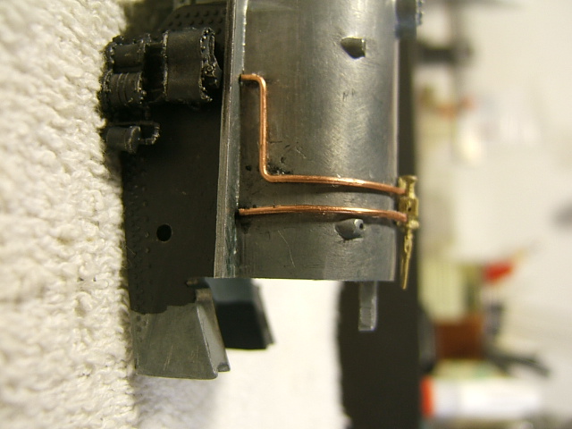

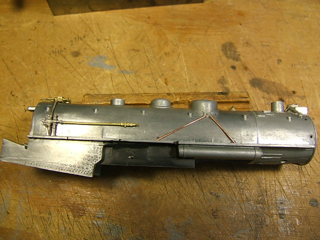

Progress....After being held up waiting on the FINAL (I hope....) lot of pieces and paint, I got down to do some serious work.... Goldth
Here's a quick view of what I've been up to....
Gus (LC&P).

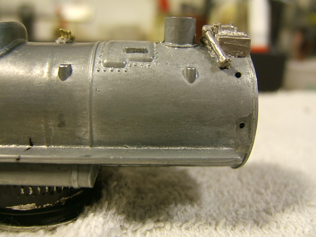

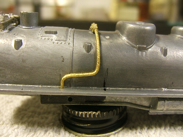

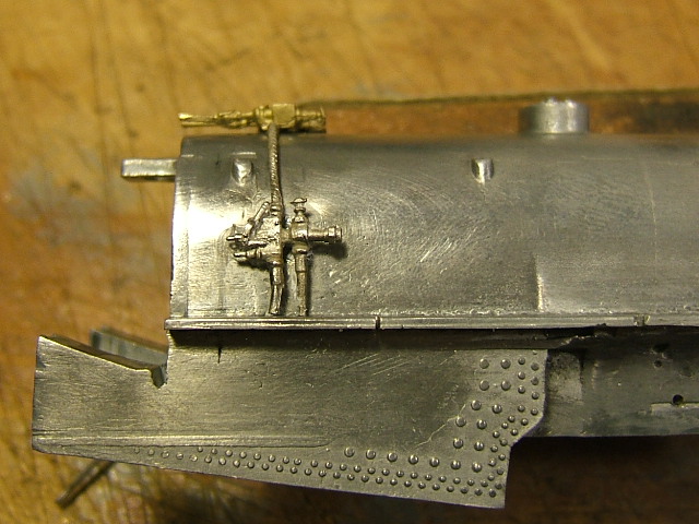

#98
So' more...
That's all folks....
Just gotta do the other sand pipes, and the overflow from the injector. This last one won't be placed until the final assembly stage (after painting), as I'm sure I'd be knocking it off with all the handling going on.... Eek

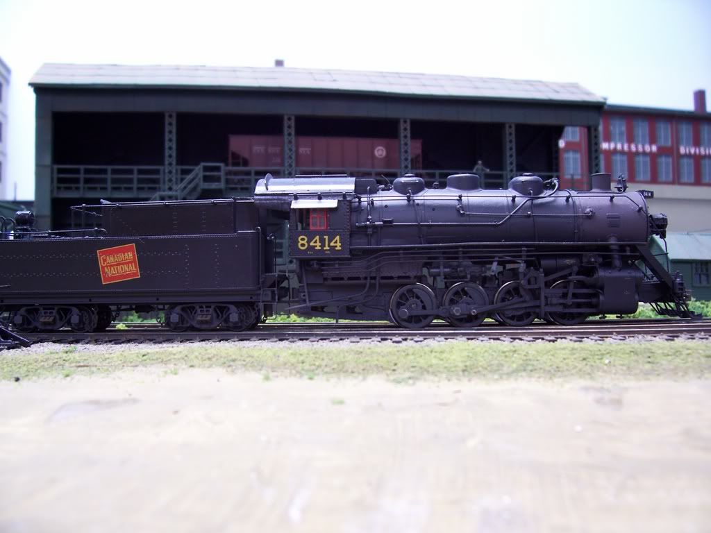

Hello Gus---great work on your locomotive so far,it's going to be a beauty when you're finished.Here's a front end shot of a Canadian National Mike.As well as the handrails,there are also a couple of bars from the bottom of the smokebox to the pilot deck---I'm not sure if they were for additional support---hopefully someone else has an explanation
[Image: P1060852.jpg]
Here's another shot---this is a locomotive that Doctor Wayne custom built .As you can see,it has the same features as the Mike
[Image: P1060827-1.jpg]
Thanks for the info....and the drooling fit that ensued.... 357

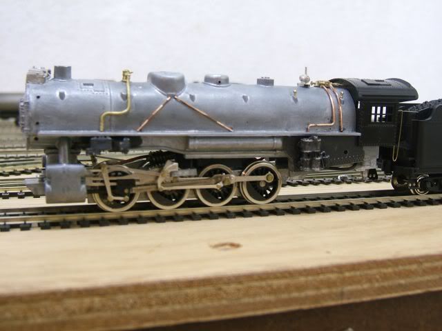

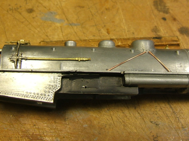

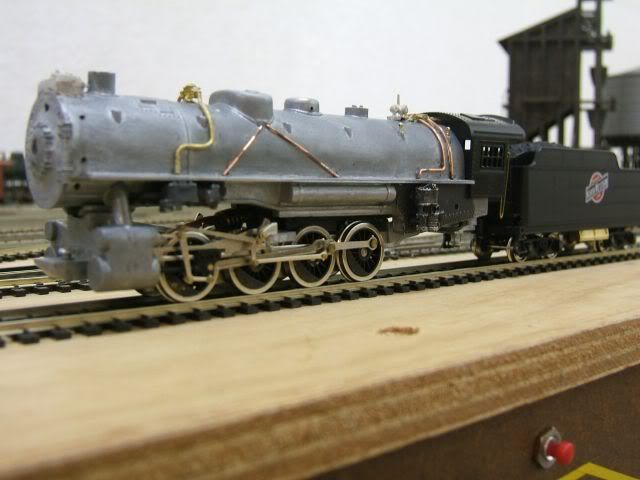

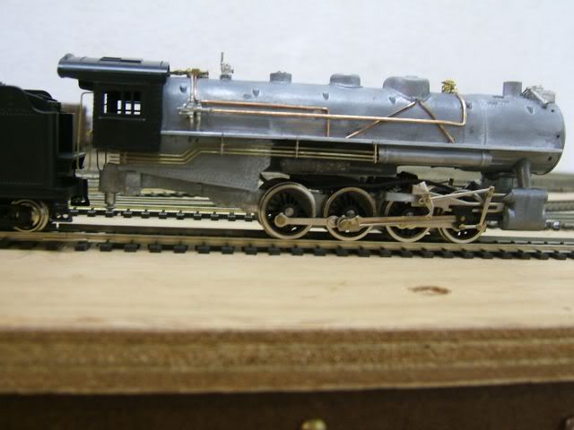

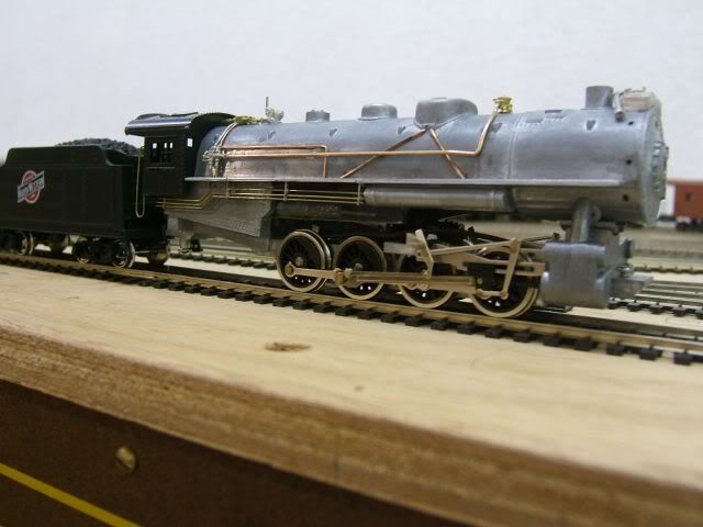

Well...It's been sometime since the last update...but now...
...THIS BABY IS READY FOR PAINTING...!!! 2285_
So..here's the last pics before she comes back in all her steamin' glory..!!
[Image: DSCF3051.jpg]
Sorry...left off the cowcatcher...But that'll be a surprise for when she's all assembled.... Goldth
[Image: DSCF3052.jpg]
[Image: DSCF3053.jpg]
[Image: DSCF3054.jpg]
[Image: DSCF3055.jpg]
[Image: DSCF3056.jpg]
Just ONE last question....How much pre-assembly should be done before painting, and what should be left for post-painting assembly..?? I'm particularly concerned with the handrails & posts. Of course, the frame/drivers will be painted separately.
BTW...The tender shown was picked off eBay, and will be painted and lettered for the LC&P. I decided to use a short tender instead of the kit's long-haul one. There aren't any "long hauls" on my RR.... Wink
Gus (LC&P).
