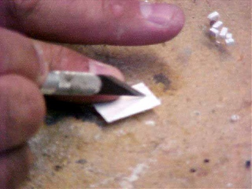

Next, I take the point of a hobby knife, & just randomly scribe some of the grooves a little deeper...

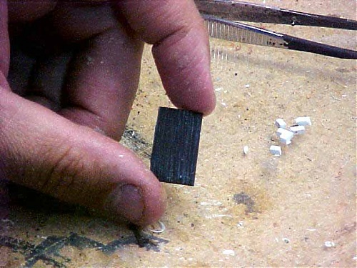

Now I paint with flat black spray paint...

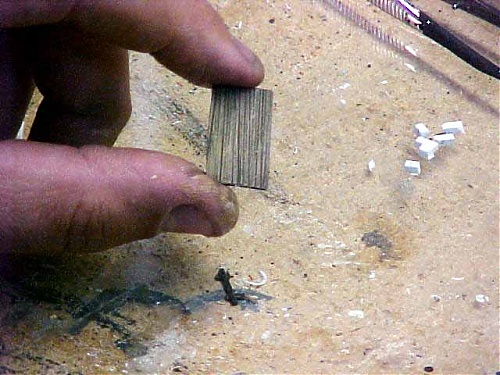

After the spray paint drues, I dry-brush with Polly Scale Dirt, Mud, Earth, & Aged White, then I give it a wash of India Ink & alcohol...
And the result (hopefully) looks like some weathered planking...
