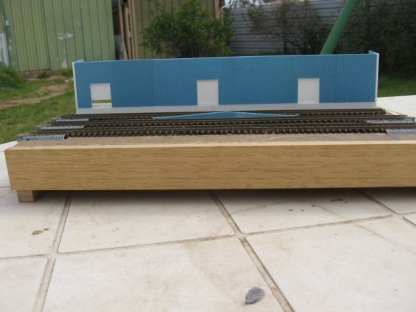

To show that my hands as well as my head has been busy these past few days below is photo of the kit-bash of a Pikestuff kit to form the basis of a small Tropicana distribution warehouse. This is a compressed version of the Cincinnati distribution center ( <!-- m --><a class="postlink" href="http://www.freerails.com/view_topic.php?id=1033&forum_id=43">http://www.freerails.com/view_topic.php ... orum_id=43</a><!-- m --> ) and will use 40ft reefers (old Atlas plug door box cars collected off E-BAY) in an Inglenook style shunting puzzle.
It is placed on a non-T-TRAK table top module that is part of an initial foray into a module based ISL.
If things work well I will start up some posts over the next few weeks on not only the building kit-bash, but also the modules for the industrial switching layout.
