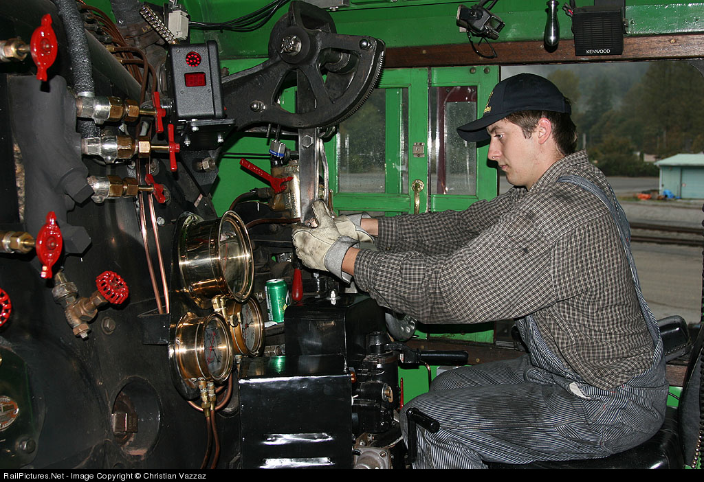

BTW, doesn't anyone knows CPR interior cab colors. Was it apple green like CNR? Couldn't find any valuable info on the web (as I said, I'm not a CPR fan, which means I own nothing about it!)...

Thanks for the link,
I finally got my answer: green! Two preserved Royal Hudson (St-Constant and Squamish) had green interior. I think I'm got to paint cab details, just for fun.
