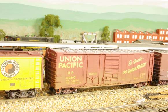

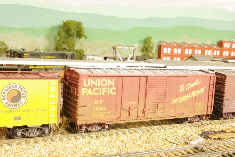

Okay this is 800 x 323 and 74894 bytes ( reduced to those dimensions in PaintShopPro X2)
and this has been thru JpegWizard and is 39104 bytes and the same pixel dimensions
and yours put thru it now 92141 bytes, - but could be made considerably smaller than that!
Thanks for the idea -- it looks like the two programs you used are pay, but I googled for a free jpeg compressor and found something called Ken Ward's Makeup, which is shareware. Same photo 700 x 469, 119K
