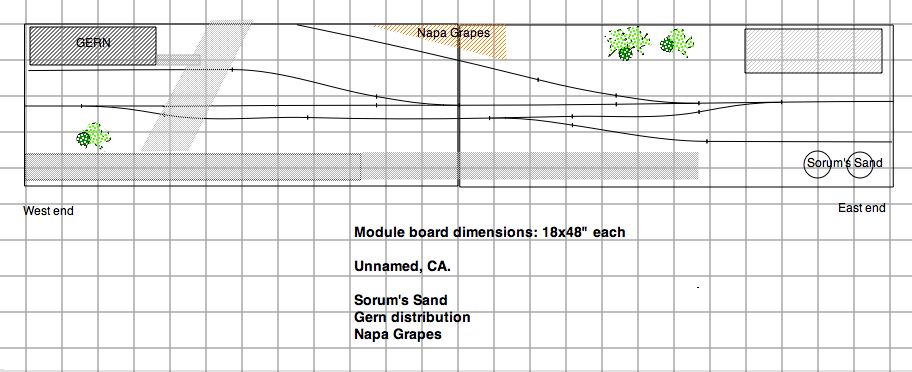

Ok thanks. I've just played about with my trackplanning software (Empire Express, on the Mac), and made another version of your Weedpatch, CA layout.
I've used Peco Code 83 no'6 turnouts in my version. You will notice that in this version, I have included a small warehouse of GERN industries, in true Big Blue tradition, and you'll find that the silo's on the right now represent an industry that deals with sand.. ;-) (not sure why the trackplan doesn't show properly, so click on the image)
I might still tweak it a bit, but at the moment, I'm just looking at it and trying to visualise it. I'll keep you posted.

LOL - I like the GERN and Sorum's sand :-)
Your version looks better scenically. But it you take the double ended siding further to the right and to the left, you will need an add-on switching lead to use the double ended siding.
The reason for why I left the runaround so short and left a foot on the main to the left of the turnout to the double ended siding and about 30" on the main to the right of the turnout to the double ended siding was to allow an engine to fit between the left end of the siding and the left end of the board, and for an engine and two cars to fit between the right end of the siding and the right end of the board.
Smile,
Stein

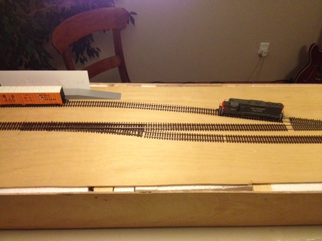

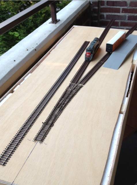

The first of two boards has been put together, made of board , re-enforced with some wooden beams and a styrofoam underlay, providing some extra rigidity and some sound insulation. The track is Roco Line code 83. While this has a european geometry , once ballast has been applied, I don't think that will be so obvious, besides, I think I'l get some Peco code 83 turnouts anyway. I put the track down loose here and am just moving it about , together with a 54' reefer , a loading platform and a GP35 to get a feel for the available space, and try to visualise what I want to do.
I'm hoping that it will provide me with some inspiration. I have also marked the 6" location from the edge to see how far 'in' the first turnout needs to be, to adhere to the module standard I'm trying to follow.
Koos

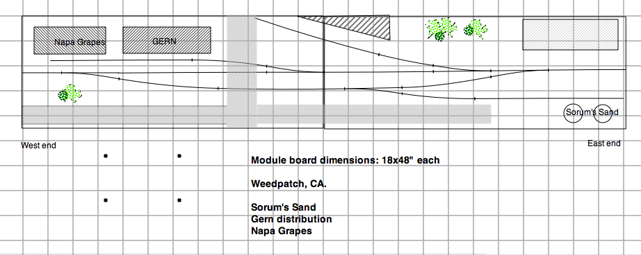

After a little bit of moving about with tracks, I decided that Steinjr's 'Weedpatch,CA' was a plan I liked. As I have a few bits of track to move about with, I have made a few tweaks to it, and here's the modified plan.
Below you can see part of it in the flesh (as a trial). I decided to place the road somewhat diagonal as to lose the 'boxy' look, and give it more of a feel that it is a slice out of a real scene somewhere. Talking of which, I am not sure about the name 'weedpatch' at the moment. While it describes part of SoCal, I would like a more believable name, it can still be fantasy, but weedpatch is just a bit too far fetched for my liking.
Does anyone have some suggestions?
