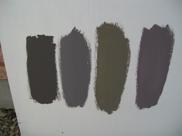

Thought I'd do a little color experiment , just for fun .
Starting from the left :
1. medium /dark grey right out of the can
2. 3 parts the above grey , 1 part white
3. 3 parts grey , 1 part white , 3 parts yellow
4. 3 parts grey , 1 part white , 2 parts red .
I'm surprised with the yellow ...didn't think it would look that good .
This is done on a white background , as it will be when I paint the roadways .

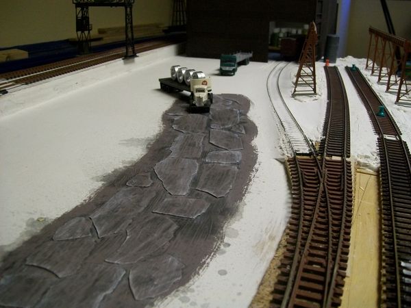

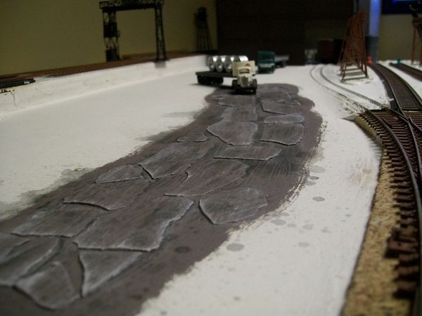

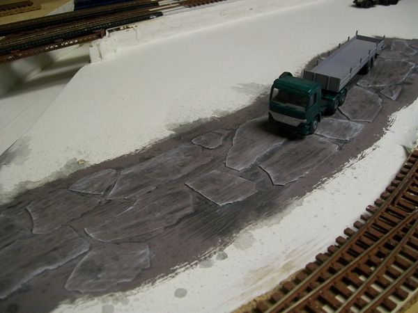

Opinions please !
This is the start of a scene at one end of my small layout . The road is supposed to be one in really bad shape because of heavy trucks running in and out of the steel facility . Granted I need to finish the scene on either side of the roadway ....does this look OK , so far ? Be honest .

Just looking at the pics , the surface of the road on the broken pieces looks a little too dark .

I would suggest to place the broken parts closer together forming smaller gaps. You may also try to wipe with a sponge over the street when the paint is still wet. That makes a nice pattern.

I was thinking of the gaps too , but the wafers of plaster ( actually Durhams Water Putty ) have already been glued down and painted over . I do have smaller pieces of the same material I could glue in the gaps .

How about putting larger pieces of plaster on the glue on the road and break it in pieces right on the road.
