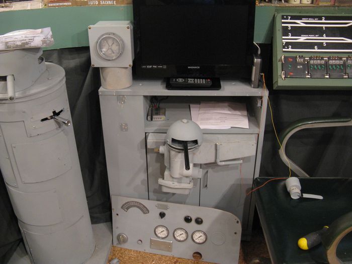

The last thing I did today was to attach the instrument pael to the cabinet. It used to be angled at the top to reflect the prototype but I decided to trim it straight to conform with the bottom of the TV screen.
[Image: 001-25.jpg]
Once in place I added some wood support for the 1/4 inch thin instrument panel. I took a picture of it after fitting it for size. I need to paint it gray and secure the structure to the cabinet.
[Image: 002-21.jpg]
