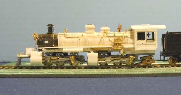

The domes on this project:
were built up with several diameters of Evergreen tubing, and several thicknesses of Evergreen sheet.
The tubing has walls that are 1/32" thick, and the different sizes, are such that they can be one size inside the next.
The domes on this loco used two different sizes. If memory serves me correctly....the boiler is PVC pipe. Evergreen tubing was also used for the cylinders.
