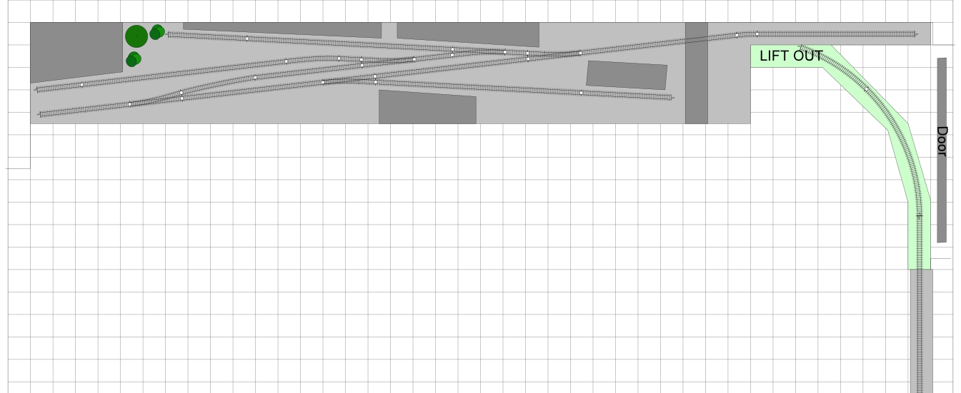

So far I 2 options drawn up and thought I would share. I haven't decided on exact industries yet but I like covered hoppers, one tank car at least and box cars....maybe the odd centre beam so a plastics, fertilizer or food processor are possibilities with a definite box car presents on the layout...have to run a railbox cars!!
I have a 4m or 13ft option which takes up the full wall but it has a door open right into it so I would have a lift out to cover that:

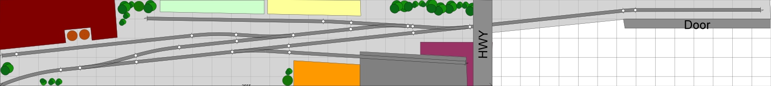

But actually I prefer this version on a much smaller footprint (2,5m or 8ft or so) that doesn't mess with the door opening at all:
You might recognize this configuration and ten points if you do!!

Looks like a version of Alcanman's Deerfield Beech layout.

My only advice would be to make sure the spot where the cars go inside the industry should be along the wall. It won't be fun at all to operate several turnouts and switch cars behind the structure. I've put a tall building in front of the siding and main line on my layout and I find it less than interesting, particularly during operating session.
Since you can fit everything without having an annoying lift out section, I do agree the second track plan is much more user friendly and easier to put together.

The plans looks nice and interesting. My thoughts
- a lift out section in front of a door that opens into the room is no fun. Everybody knocking at the door will be your natural enemy. I would avoid it.
- a lift out section as a 90° curve is not stable if simply put down and it will stay in the way if mounted with a hinge. May be too complicated.
- a larger building in the front blocking the view and the 0-5-0 makes switching physically complicated. Go for a team track, scrap yard etc. in that spot.
Wish you the best to implement the plan soon!

Your track plan looks very similar to a design in one Lance M's books. Do I collect 10 points? 357
I like the simplicity of this plan and I did use it as the basis of my Deerfield Beach layout ( well spotted Jacques) . I simply add an additional spur
I agree that plan 2 is best and also avoid having large structures at the front of the layout they can get in the way.

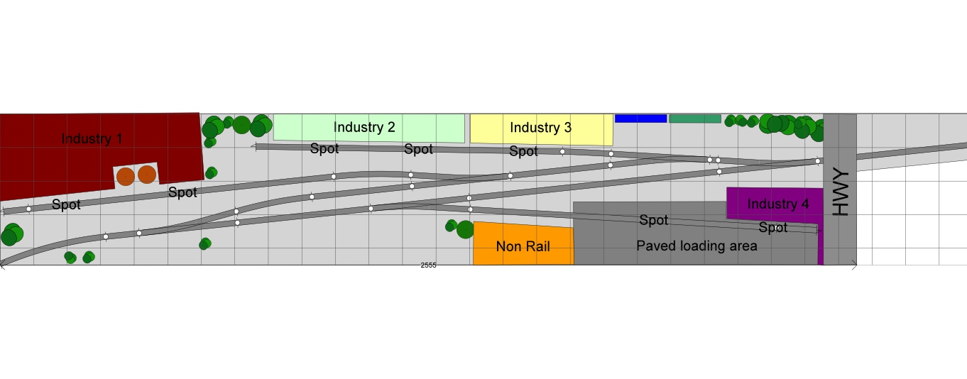

Perhaps I should have posted a little more info first, don't have much time for these posts so they done in a hurry... Agreed on all points made but to clear up I dont have any internal offloading, think the bottom industry and detail was misleading.
The plan is a mirrored version of a plan from Lance M's books....just works well and I've adapted it to fit, not very original but its a start. if you read my lasy threads my design changed quite a bit but I like that this is modeled after a real location.. I prefer the wall staging behind the door if open, as stated it never becomes and issue and its far more reliable.
1. Plastic or food producing at Industry 1 with 2 spots, one of each type of rolling stock or 2 of the same depending on requirement for the week
2. Box cars at Industry 2 with 2 spots, box cars only....pref some Hi-cubes.
3. A single box car at Industry 3 that is seldom in place, perhaps in the 90’s it was decreasing its rail demand…kinda a half served industry.
4. Max 2 spots at Industry 4 at the front, if not only one most times, this would be an open paved lot accessed after passin behind a low relief non-rail served building. It could hold timber on bulkheads for forklift offloading in the first spot and a boxcar for loading at the doors of the purple building to the top, maybe a furniture manufacturer . this structure would be modeled to indicate a bigger building under the overpass.
Here is a more detailed plan in ft:

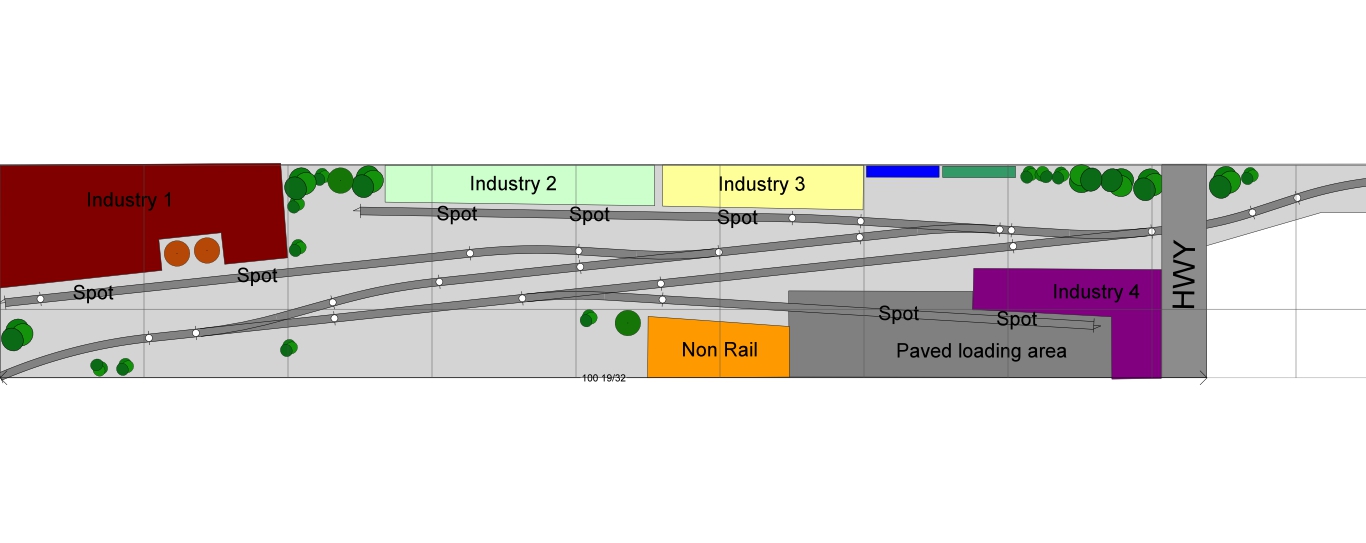

I'm guessing in this small a space you will be modeling in z scale?
Tyson Rayles Wrote:I'm guessing in this small a space you will be modeling in z scale?
Mike, A 8' long layout like the above will work quite well for a small HO ISL. With 4 axle yard switcher like a SW8 or Alco S-4 and 40' cars you can build a nice ISL on a 1x6 foot board.
Larry
Engineman
Summerset Ry
Sorry that grid was definitely not in feet:
Here is the feet version...yes about 8ft x 1.5ft for the actual layout without the staging:
