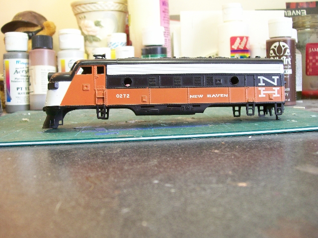

Someone from work gave me this old Athearn F7 shell. He just wanted the drive. I had a drive, with a chewed up shell.
The paint job on this was pretty bad. Lettering and color seperation was horrendous. At first I was going to improve the paint and replace the lettering with decals. Then I decided to make this the power for abusiness train.

First, I scrapped off the plastic nub "lifting eyes".
NARA Member #87
Removing the horns(I'm going to use only one), I then sanded smooth the mold lines using 600 grit sandpaper.
NARA Member #87

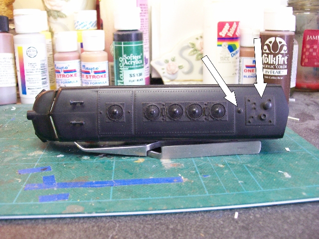

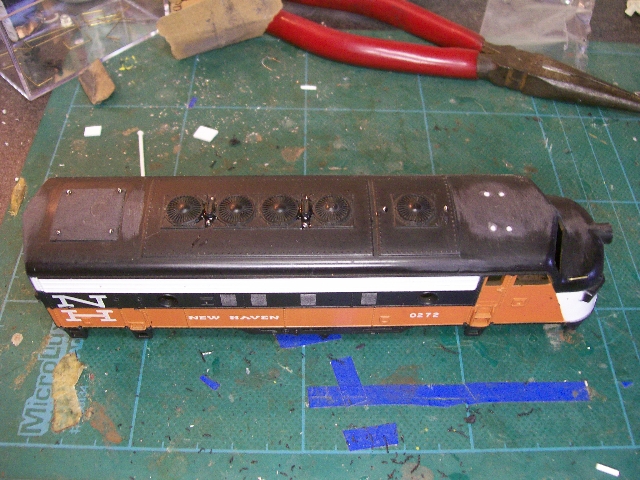

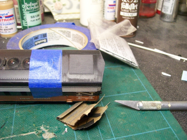

Next, I chiseled off the steam generator details, and sanded smooth the roof panel.
NARA Member #87

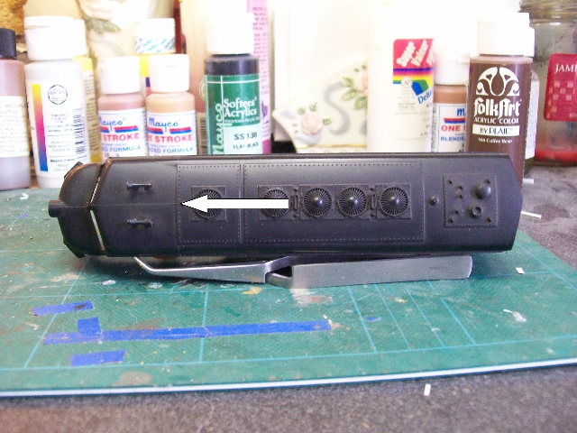

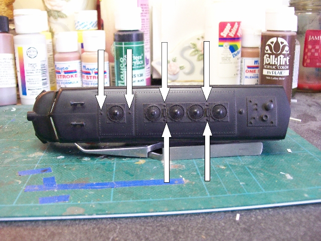

After I took care of the steam generator panel, I moved my attention to the holes left over from the horns. Using Evergreen Styrene Plastic rod, I plugged the holes, using CA(super)glue. When that had set, I trimmed the nubs and sanded smooth.
A little foresight...I could of waited to sand the mold lines, when I did this step.
NARA Member #87

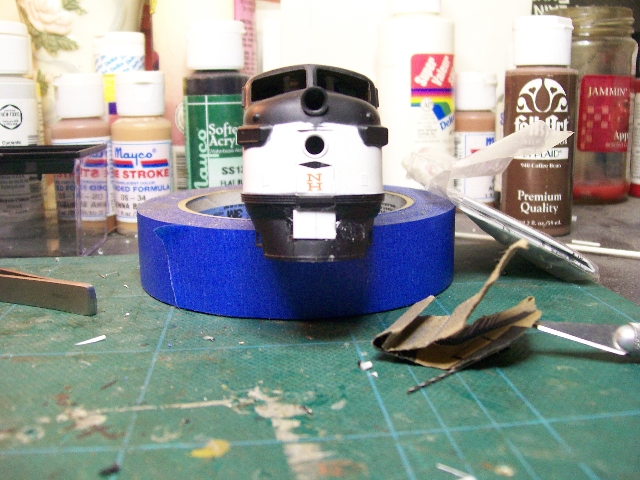

For some strange forgtton reason, I had cut the front portion of the frame of the drive off(Actually I think I got it that way at a show), so I fashioned coupler doors from styrene sheet.
NARA Member #87

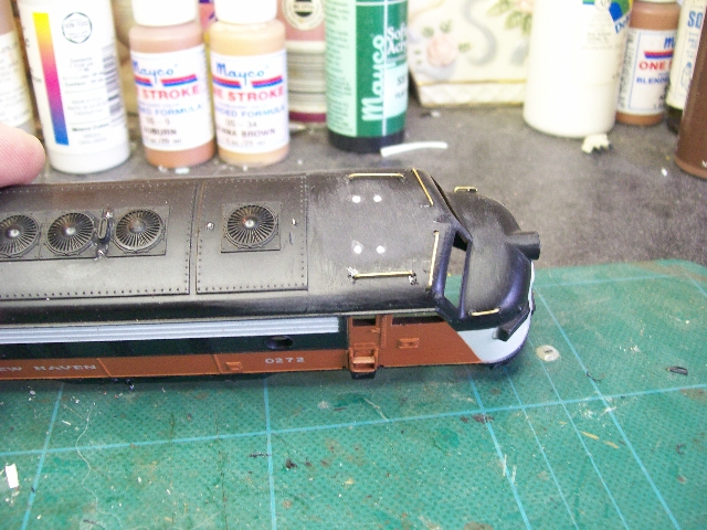

I then drilled the holes for the handrails, grabs and lifting eyes. After that I installed Deatil Associates eye bolts(#2206) in the roof panels. After that had set, I washed the shell in warm water and I'm letting sit over night.
I will add the grabs and handrails after I paint the shell. Though I did put one on the nose.

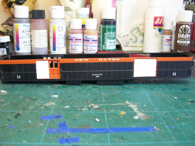

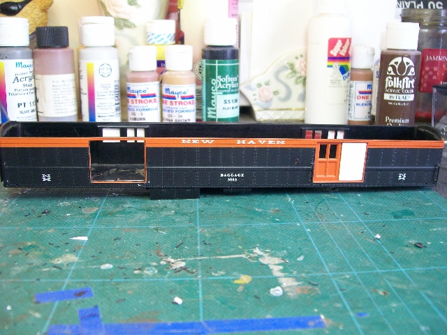

An old IHC Heavyweight baggage car is being transformed into the generator/tool car.
I cut the one door out for the radiator for the generator.. I also blocked out the other side, and one door each on the opposite end.

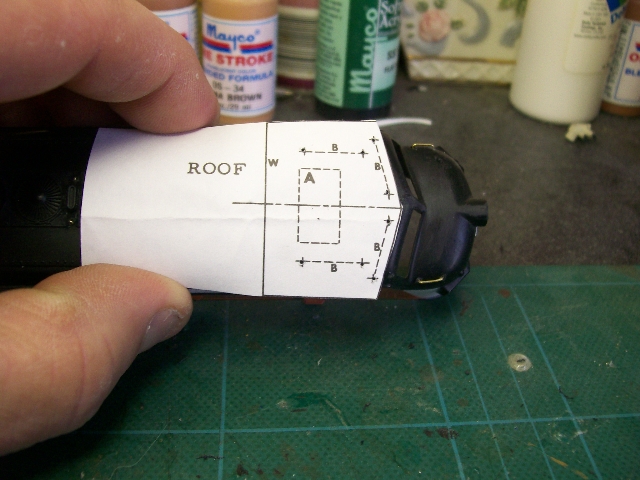

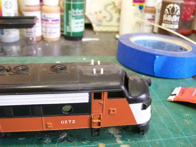

Unfolding the instructions to get a number for the "Dress-up" kit, which by the way is 770201(Probably not available anymore since the Horizon take-over of Athearn), I noticed templates for the roof grabs.
Using that I drilled holes for the roof grabs, then installed them. Then re-washed for paint.
