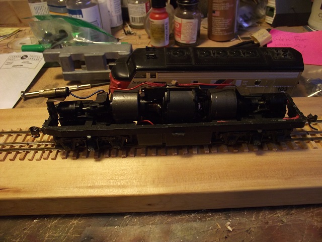

I started with an older-model Athearn F-unit. The ones that come with the cast-metal sideframes on the trucks. The newer trucks with the square axle bushings won't work.
[Image: 202042131815_DSCF8596.JPG]
This unit was well-used and needed some wheel cleaning and lubrication before it started moving.
I ran it for a few minutes before disassembling it.

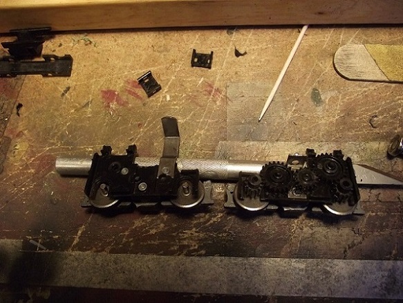

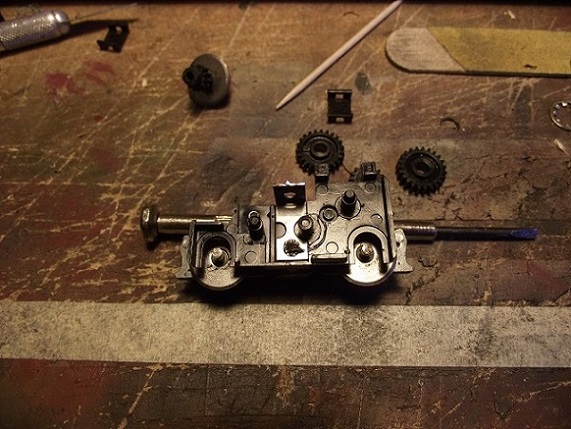

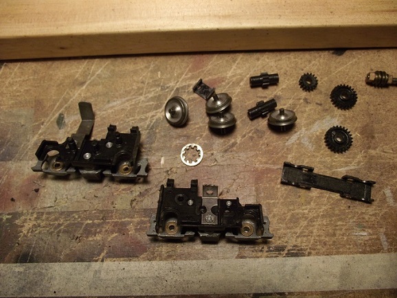

I then disassembled both trucks and cleaned all the parts with Isopropyl alcohol and let them dry.
[Image: 202042132332_DSCF8600.JPG]

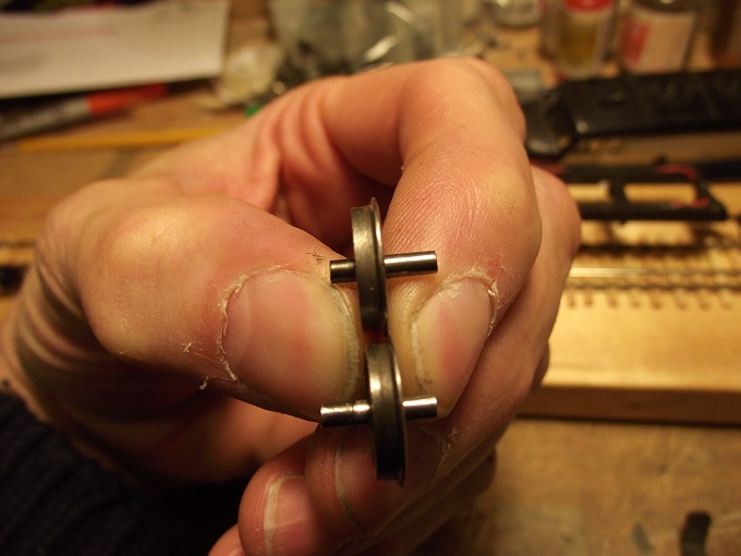

six parts have to be modified in each truck, the four wheels and the two axles. The wheels need to have their metal axles respaced and moved outward. I used a NWSL sensipress to do this. The modified wheel will have .14" of the axle on the inside

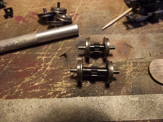

The plastic axle/gear will also need to be shortened, but equally on both sides. I found that shortening the axle from the gear to the end to .113"did the trick. I used a sanding disk in my Dremel to shave the plastic axle down, checking with my digital caliper and a kadee wheel gauge as I went.

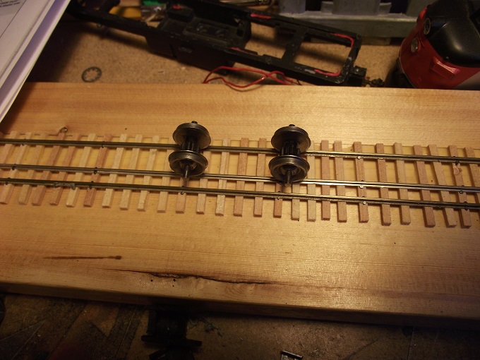

I also checked the completed wheelsets on my test track and they roll just fine.

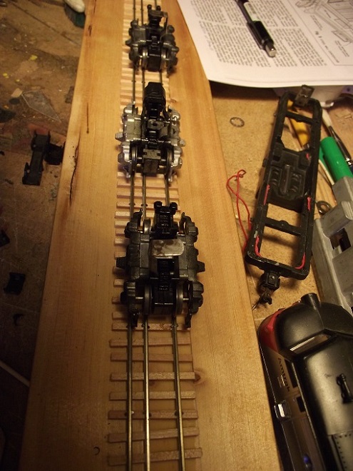

I re-assembled the chassis and ran it on my test track. It runs just as well as it did when it was standard gauge.

I started with an older model Athearn F-unit. One with the metal sideframes on the trucks, the newer engines with the square axle bushings won't work.
This unit was well used and needed some wheel cleaning and lubercation before I got it moving. I ran it for a couple minutes Before dissasembling it.
I then dissasmebled both trucks, cleaned them with isopropyl alcohol and let them dry.
Six parts have to be modified in each truck, the four wheels and six axles. The wheels need their axles respaced and moved outwards. I used a NWSL Sensipress to do this. The modified wheel will have .14" of the axle on the inside.
The axle gear will also have to be shortened, but equally on both sides. I found that shortening the axle from the end to the gear to .113" did the trick. I used a sanding disk in my dremel and a digital caliper to check my work.
I also check the competed wheelsets on my test track and they worked just fine.

I reassembled the chassis and it runs just as well as it did when it was standard guage.
