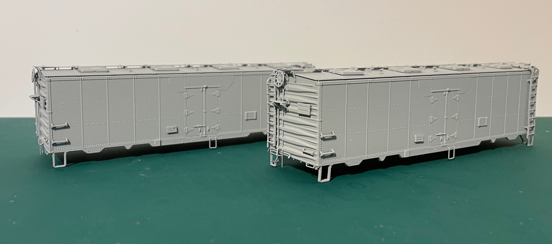

I started the project a few weeks ago. Here is the first step : Cleaning the parts and putting each kit in its own tray.
I will post more photos in a near future.

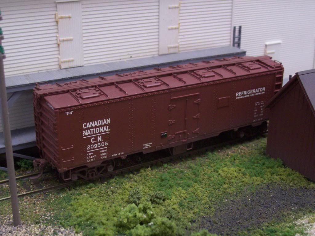

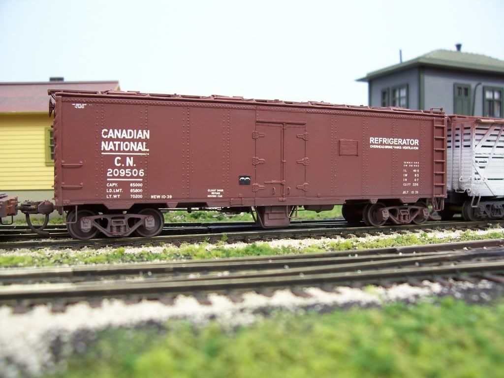

I made an early version of the CNR cars, using a modified Athearn kit...
.....and with an October, 1939 BLT. date, it managed to just squeeze-in to my layout's late '30s era.

(10-07-2021, 11:40 PM)doctorwayne Wrote: I made an early version of the CNR cars, using a modified Athearn kit...
Really nice car with outstanding details. Great modeling.

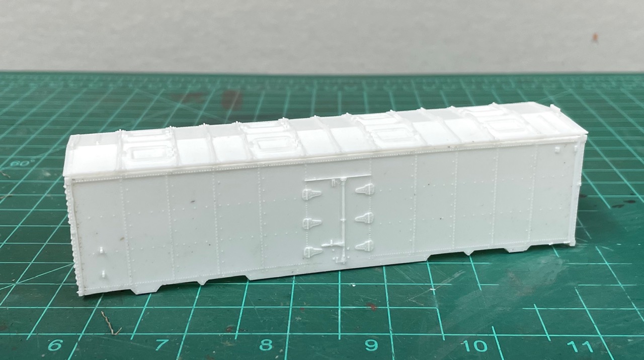

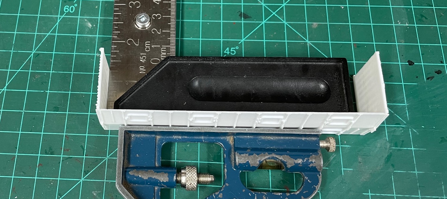

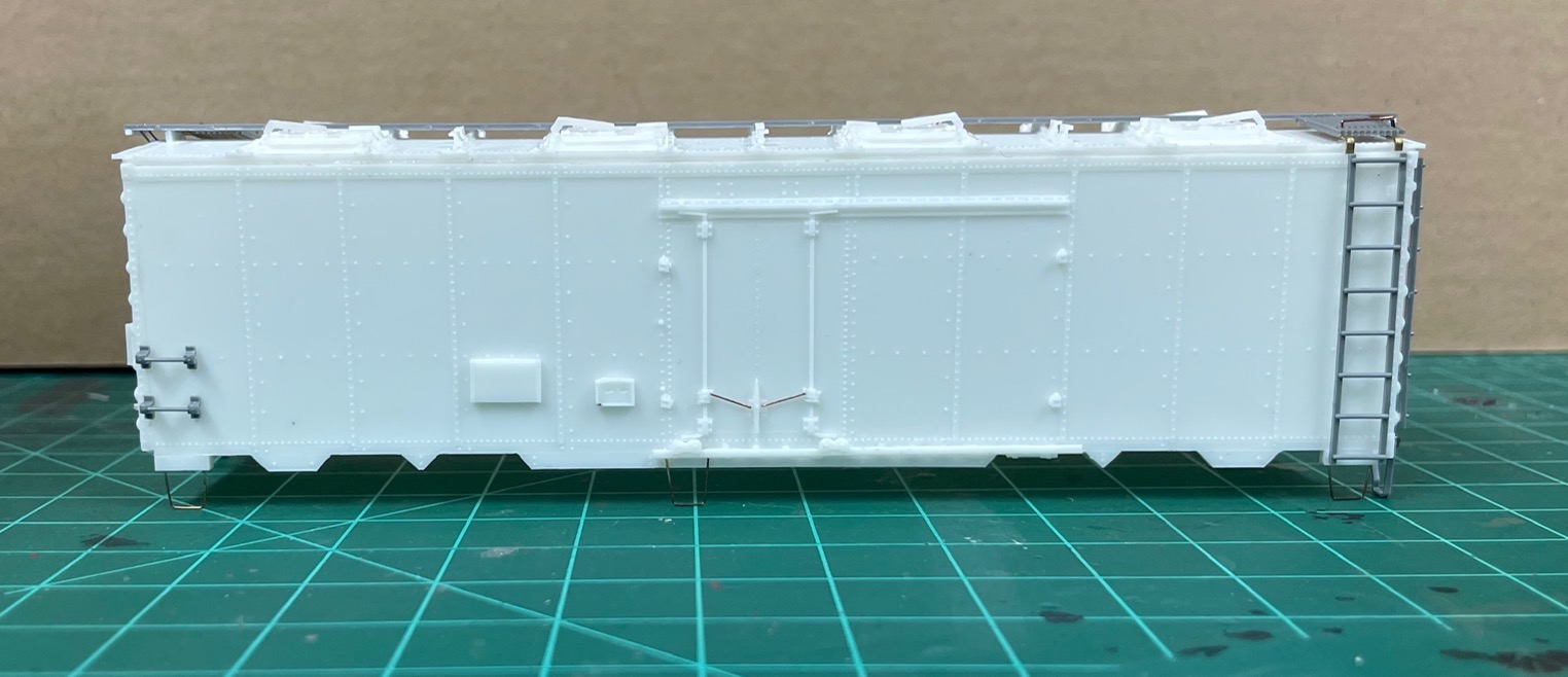

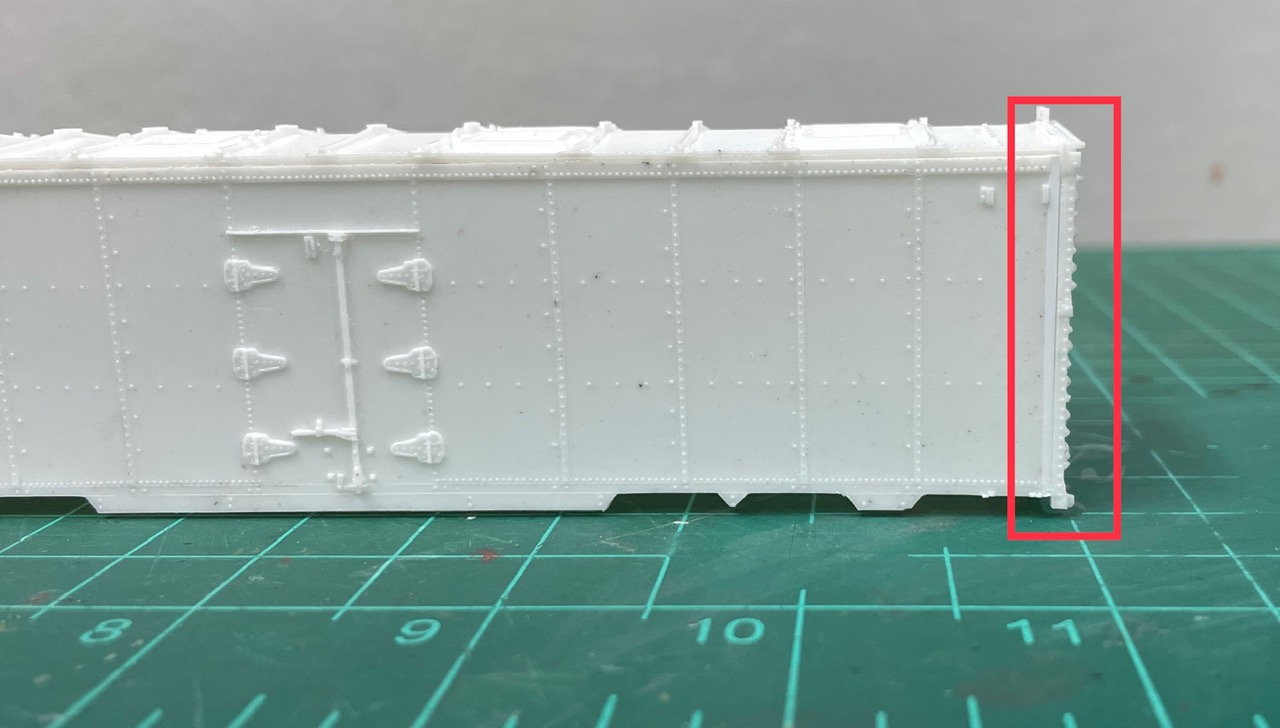

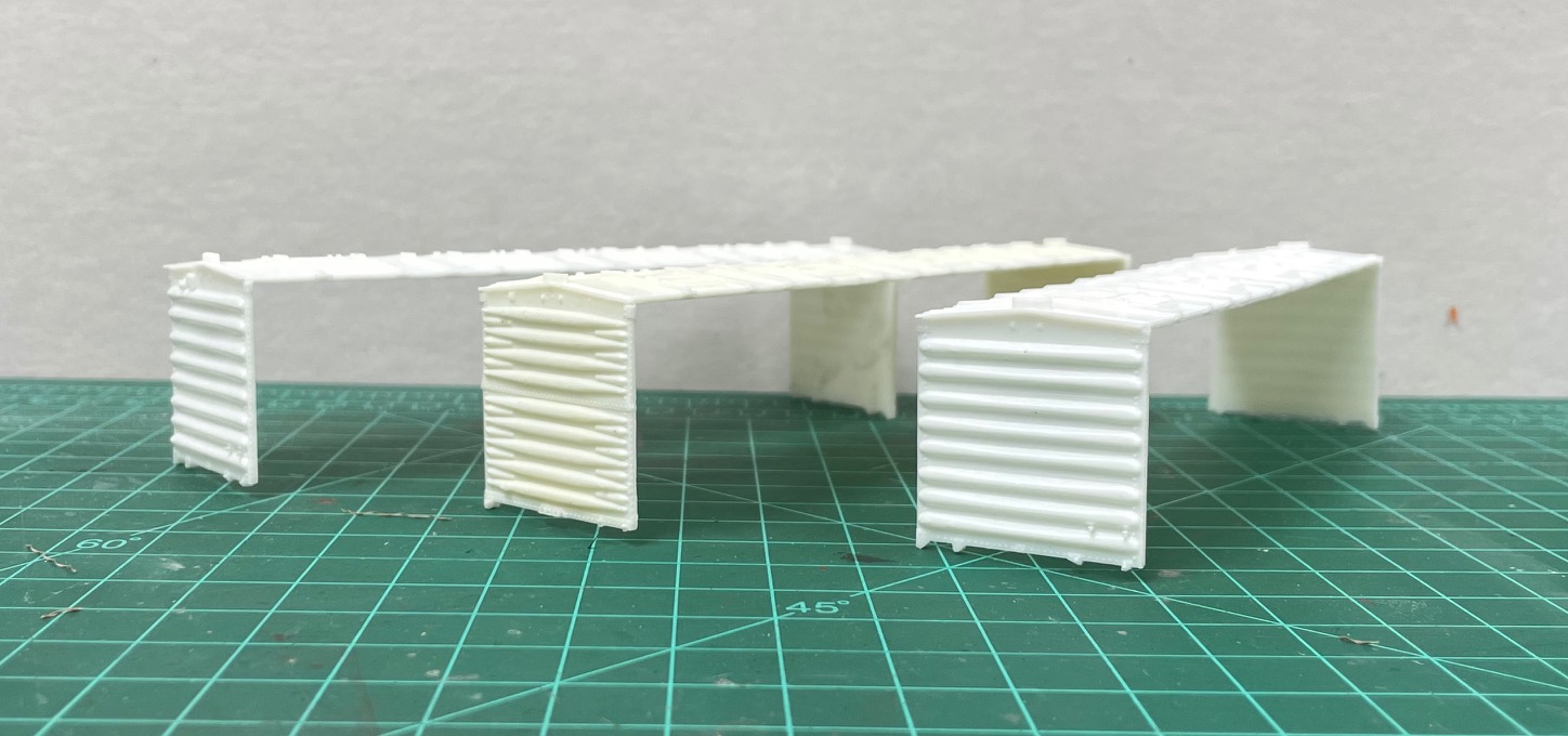

I began the assembly by attaching the ends to the roof. At this step, it's important to make sure everything is square and well adjusted so the finished car will be square.
I then added the sides.
The sides of one of the cars were too short. I decided to add a piece of styrene at the end where there will be the ladder so the repair won't be noticeable.
So far so good.

(10-08-2021, 03:24 PM)CNR5103 Wrote: The sides of one of the cars were too short. I decided to add a piece of styrene at the end where there will be the ladder so the repair won't be noticeable.
Slick improvisation, Guy.

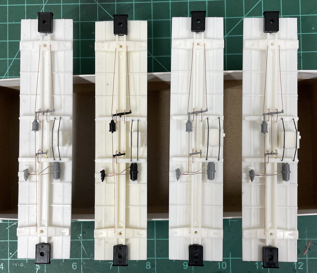

After the bodies were assembled, I should have continued with the roofs. But I wasn’t ready to tackle all those small pieces (more on that in a future post) so I went for the floors.
Guy from Southern Quebec.

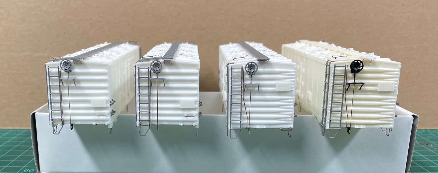

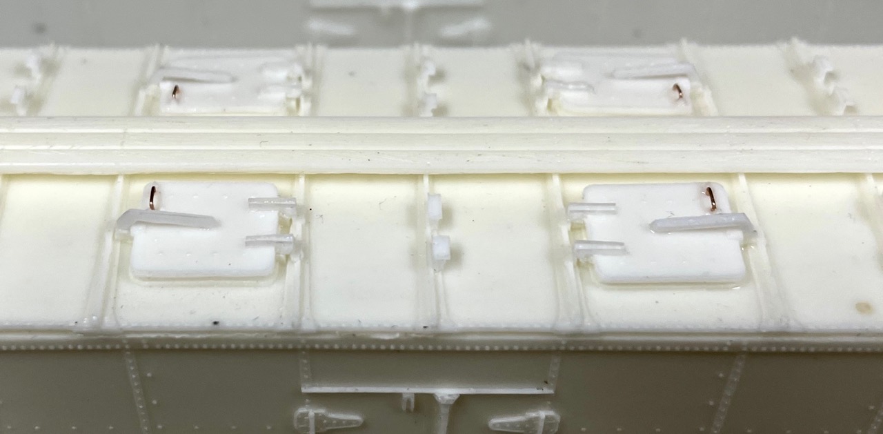

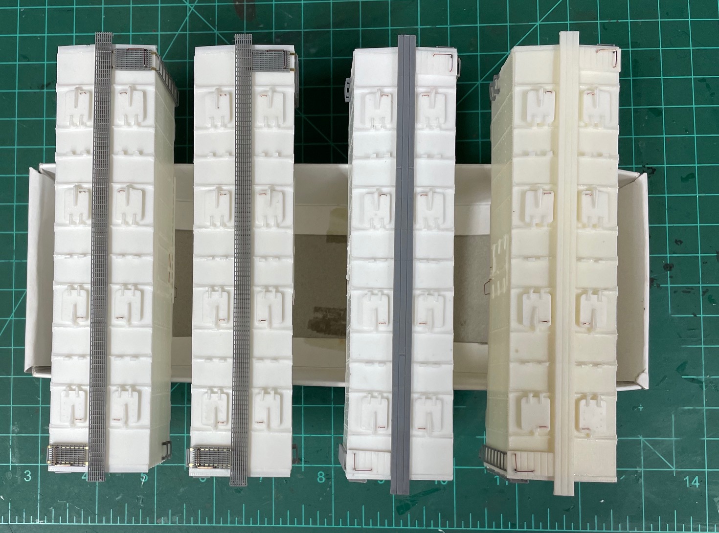

The under frames being completed, I had no choice but to tackle the roofs.
4 cars times 8 hatches = 32 hatches, 32 latches, 48 rests, 32 handles and 64 #80 holes.
No wonder I hesitated so long to start the project.
Next step will be to finish the sides and the ends.

Awesome !The detail is incredible.

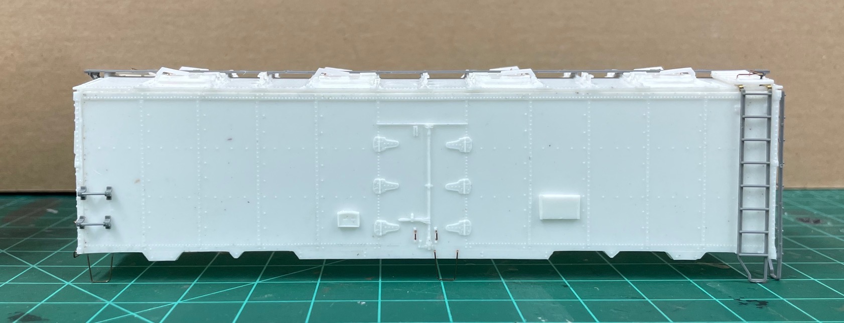

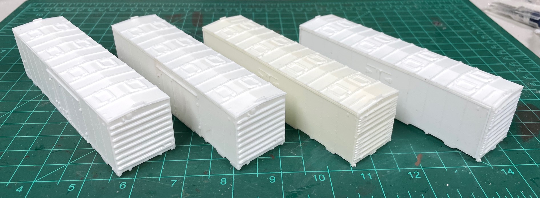

Sides were a breeze to do.
It was not so easy with the ends.
The assembly of the four cars is now completed.
Ready for the primer and then the paint room. However, I still have to find the right paint.

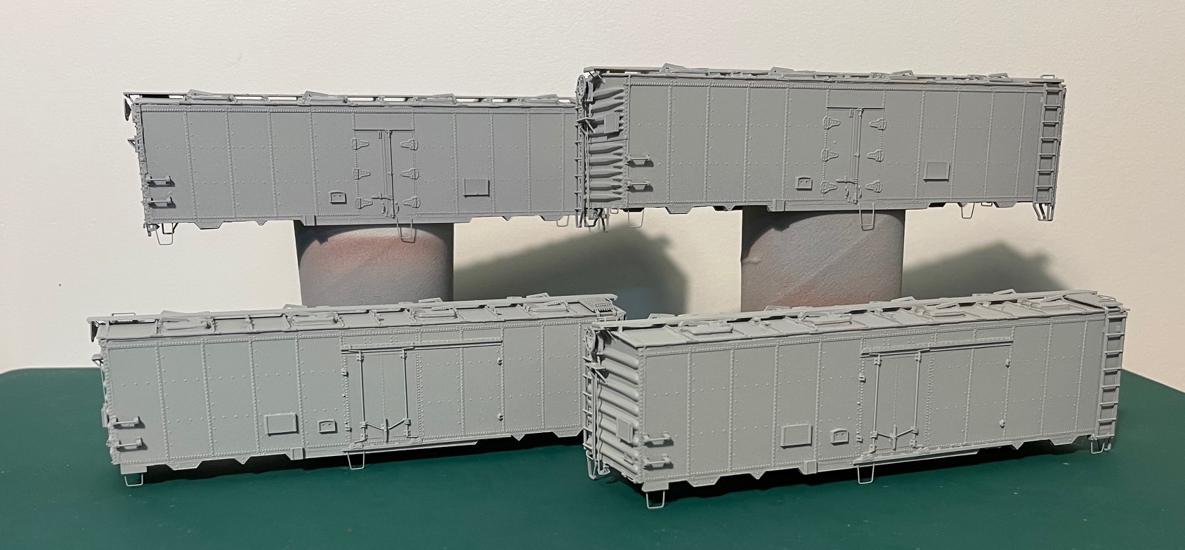

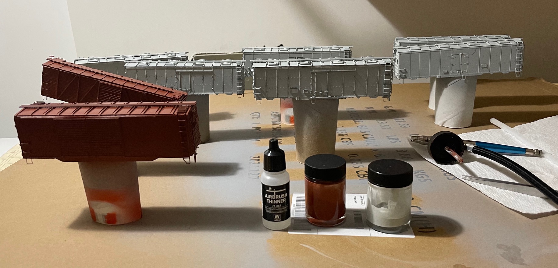

Today was the right day for the paint shop.
A photo of the four Funaro & Camerlengo kits.
When I had finished the assembly of those cars, I decided to repaint two True Line Trains Reefers because I have never liked the color which was too dark to my liking. I first tried to strip the paint off them with Simple Green and isopropyl alcohol. The Simple Green did absolutely nothing and it took no less than five days in a bath of alcohol to get rid of the paint on a first car with a good scrubbing with the result that some small parts were broken and had to be repaired. As the paint on those cars was pretty thin and smooth I decided to let the second as is and paint over it without striping the paint. I Know this is not a good modeling practice but, after priming and a coat of paint, I barely can't see the difference between the two.

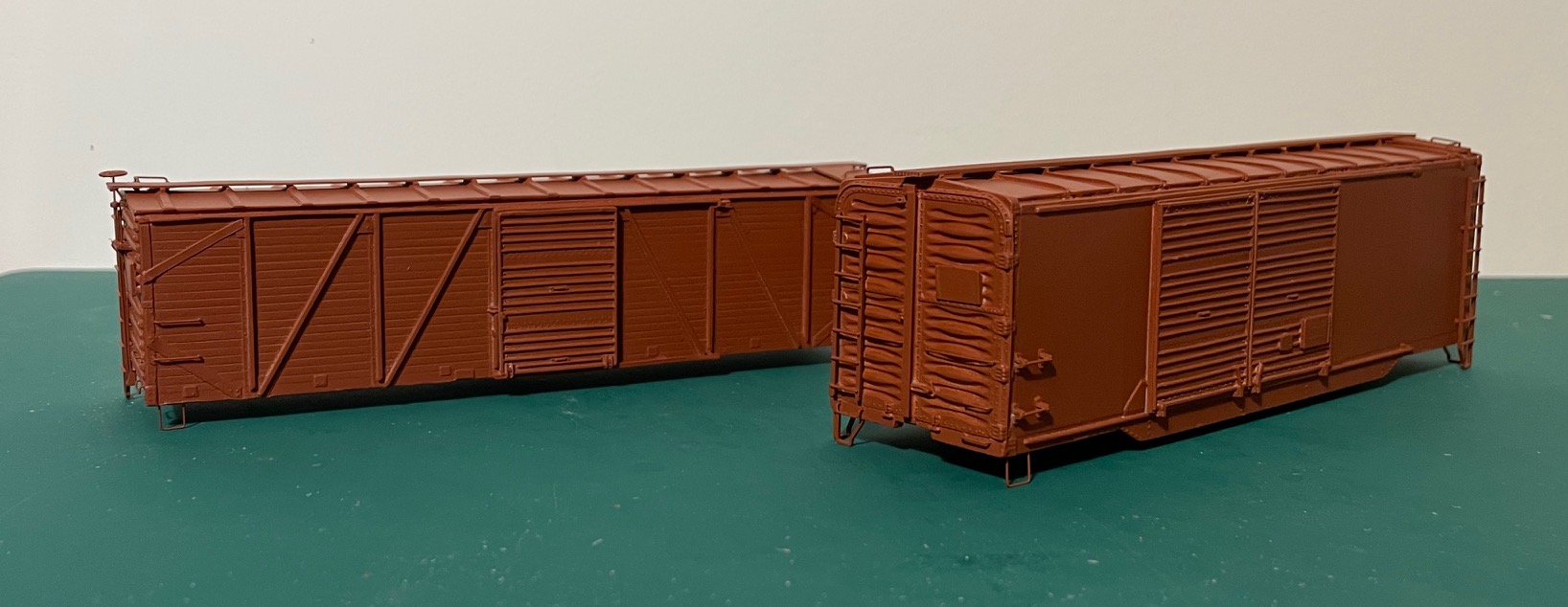

While the laundry room was transformed into a paint room (thanks to the girlfriend), I decided to take advantage of it and proceeded to the painting of two boxcars which were waiting on a shelf for quite a while.
That's what I call a good day at the office.
