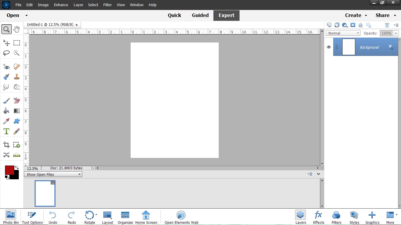

Here is my main screen. I have started a new document that is 8 x 11 inches and is a resolution of 300 Dots Per Inch (DPI)
I will start by adding some text. Select the text tool (T) in the left column, chose the font from your font menu at the bottom of the page, them chose the font size (this will be changed to meet the needs in the nest step
