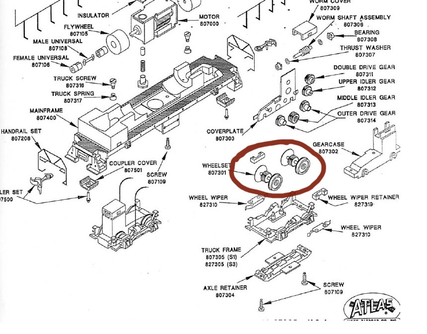

I am in need of 1 geared axle for an Atlas 8000 series S1. The part has not been available from Atlas for a number of years and the cost of NWSL gears (if they have them) are more than I can spend on a new locomotive. The S1 I have was new old stock and had 2 bad gears. The one was still available. It's a shame the manufactures don't keep parts for these models because most of us have locomotives over 20 years old and these axle gears seem to be a problem for a lot of different models. I have replaced at least 60 axle gears on Athearn and proto locomotives and even had to replace some on BLI steam locomotives.
The part is 807301 and there is nothing else that I have found that will work.

I looked at the diagram and found a picture of the center idler gear on atlas' web site. I counted the teeth and they were the same number so I gambled and searched for that part number but the only ones left were in Canada so I found another gear with the same number of teeth on the Atlas site and since shipping was 6 bucks I ordered 4 of them at 1.50 each. I had to press the gear on the axle and I must report that the locomotive is now repaired and ready for the paint shop

I thought I should provide some part numbers for this. The original wheel/axle gear set is Atlas part number 807301. The gear I found that will work to replace it is Atlas part Number 807313. It has to be pressed onto the shaft in the exact position because it is slightly wider where it fits the shaft. The axle also fits other Atlas models so the gear should work there too. The broken axle gear had cause the double drive gear (807311)to break too but it is still available.
