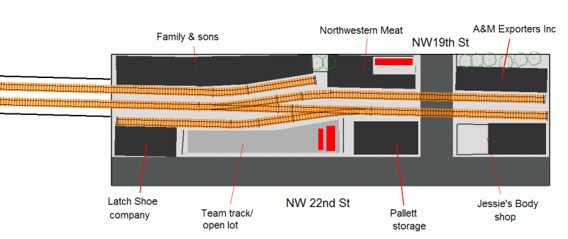

The plan is to model a section along the downtown spur along NW 22nd St. For me this model will be small and to what you guys would probably call a micro layout. Its only 5' long by 20" deep. Its based on the concept of less is more and prototypical style operation with just a couple of spurs off the main. The time period is current, my UK modelling is set in the 1980s so I chose to model the current day with my US modelling as I was starting from nothing.
Anyway I'll leave you with the track plan for now and I'll post up a little more detail and information as I catalog the building of this layout. There will be quite a lot of updating as its due for an exhibition in June this year so I've got a lot to be getting on with.
Here is the plan all the building labels equate to real plots that can be found on google maps if you look hard enough, its not an exact copy of the area as some buildings are taken from different parts of the area and arranged to fit the layout.

Re: Northwest 22nd St, Miami - Gary S - 03-25-2011
Dave, the NMRA track gauge has clearances on it. Here's a link to the NMRA page that explains everything. http://www.nmra.org/standards/sandrp/gauge.html
Alternatively, you can just use some rolling stock to determine the clearance, put the building just a tad away, maybe 3/32" or so. Also, I have found that locos with sun shades over the windows are sometimes wider than boxcars, so allow for that if engines will be running next to the buildings. Also, more clearance is required for curves.

Re: Northwest 22nd St, Miami - jonte - 03-26-2011
dave_long Wrote:There is due to be a fiddleyard/storage area at each end of the layout so that it can be a through layout for exhibition purposes.......
Dave
Great to hear that you're managing to strike some sort of work/modelliing balance, and hope you received my post on your excellent blog site Thumbsup
Now, this is something that's been nagging me since I first saw your plan and as a 'Newbie' I've been putting off mentioning as it could be taken as a case of , "who's he to be lecturing a journeyman modeller as to how to proceed ....." etc. Also, If I did pluck up the courage to say anything, perhaps I should do it privately on your blog rather than in open forum, but as I feel we're amongst friends here, I'm sure I'll be given the benefit of tolerance - plus there'll be an opportunity for others to put me in my place Wink , so here goes:
I presume that with the benefit of a fiddle yard at either end you'll be engaging in 'running round', in addition to the 'Inglenook' type shunting which will, without doubt, add immensely to its operating potential as well as making things a little more prototypical? However, as a seasoned 'armchair modeller' with a library of modelling journals in the loft and the benefit of attending one or two exhibitions over the years, I'm aware that 'punters' feel a little short changed if they can't witness the entire procedure of the engine running round its train; in other words, ALL running round should be done on the scenic part of the layout. With such a small amount of 'proposed' real estate available I realise that this is not an option, which is why I thought I should mention before any track gets laid and while you're still in board building mode.
Additionally - I'll shut up after this - while 5' is small enough in British Railway Modelling terms, it is positively tiny in Railroading terms, bearing in mind the difference in length of even the smallest American stock to the humble British van. For instance, my plan - yes the one on the back of that old envelope Icon_lol - is based on Butley Mills - itself a micro at around 7' in viewing length, however, I had to adjust it accordingly to accomodate the larger American stock, hence its 9' length.
If this was just for home viewing, Dave, I'd have said absolutuely b*gger all, however, as you intend this for exhibition purposes, I thought I'd just give you the benefit of what little knowledge I have to make a slight improvement on what will inevitably prove a masterpiece.
Whatever you decide, be assured I shall be keeping a close eye to developments, and do my utmost to attend its first outing at the TVNAM (?) exhibition in the summer.
Jonte Smile

Re: Northwest 22nd St, Miami - dave_long - 03-26-2011
Hi Jon
No worries any input is helpful. I haven't gone into this for a couple of reasons. The viewer will be able to see both fiddleyards and what happens in them, the main FY to the left which is where the operator will stand will be a cassette based system as this will make life easier to sort out the unlinked spur. I haven't had a chance to upload photos of the actual board itself yet from which you'll notice that unlike most exhibition layouts where the backscene turns 90 deg at the back corner and runs to the front usually with a hole in for the train to pass through into hidden fiddleyards well this isn't the case.
Alot of my influences on US layouts have been from friends locally to me who build small layouts and were ( sadly missed ) well connected with Carl Arendt. Have you seen Haston by C Gilbert http://www.rmweb.co.uk/community/index.php/topic/558-haston/ That might give you an idea of what I'm building a long with ChicagO fork layout http://carendt.us/scrapbook/page98a/index.html#ho-chicago Both of these layout dont have end uprights for the backscene and Chicago fork shows that visual FYs can be well presented. Anyway at exhibition everyone always wants to look over and see whats going on in the FY.
The right hand FY will however for the short term be just a run around loop but probably ballasted so that it looks as though it fits the scene but that it is obviously a FY if you know what I mean. Then in the future a second layout may be built to attached to it.
I'm certainly going for the less is more idea at the moment, have a read of lance mindheim's recent blog entries on his ideas about how to operate a small layout, and then you can see lots of potential. Its all about the details, thats what I hope will make the layout something good to look at.
Great link Jon, not seen that before and some great detail shots, I like the red tank with the garden on the back platform.
The turnout situation might have solved itself along the same lines that your trip out to hattons solved your issue. I've found a supplier of code 70 Shinohara switches, just a bit cheaper too. So I might check with myy ME supplier to what they think about timescales and try the shinoharas next week, would speed things up quite a bit too.
