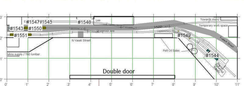

I just set up a 15" half-circle and set a gp-7 and some 50' boxcars on it and they run good on it, it doesn't look good visually but it will work. all cars stayed on the track even at higher speeds and no problem with the couplers.
You should be okay with 15" curves, although I still suggest going without them.

You can make cars go through 15" radius curves. German Märklin trains routinely do 14.7" radius curves - with free swiveling trucks and couplers mounted on the trucks instead of on the car.
I would be more concerned with the seemingly very tight aisle (about 20" wide?) aisle at the right end of the layout. It is hard to see that having a single staging track there adds that much in operational value - and having it there seemingly forcing 15" radius curves and a narrow aisle.
A drawing to scale and a description of the room would be useful.

The room is a 3x11 double door walk in closet in my garage. The shelf has been up for over a year, and as long as I don't have junk laying around in there, I can get around no problem. It's 52" to the top. The tip of my nose touches the top. After a lot of poking around at empty walls in my house, I decided this was the best place. I run a full-time t-shirt screen printing shop in the garage and what ever is in the main part of the garage has to be kept accessible, anything else is secondary, including the layout.
Here's my rough drawing I use for re-arranging the shop, from my desk....

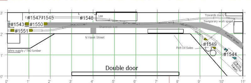

macmiller Wrote:It's 52" to the top. The tip of my nose touches the top.
Hmm - that explains it - at a height between waist and chest, that aisle would be very narrow. But at chin/nose level, we have a much narrower cross section.
Looking at the prototype, I would still be tempted to not include too much line at the far right (the area between Rupert/Shamrock and Cullen Street), put Lee and Gachman on the same spur, quite possibly flip the access to Jahn's supply (the one you have labelled TBD lumber and door), so it the turnout branches off towards the left instead of towards the right. That would also give you some much needed work space to hold outbound cars during switching.
Mmm - could also squeeze in Shields Industrial Supply at the same track as Felt Oil Sales.
Something roughly like this:

Using a Peco RH Setrack curved turnout (both tracks nominally 24" radius), would solve this problem, allowing the tank car(s) to have a seperate siding on the left, and running the other track either alongside, or into, the Shields Supply building - Felt Oils building could move into the space no longer occupied by the extension of the Oils track - giving clear trackage along the frontage

As for having two industries on the same track - nothing wrong with that and it adds operational interest to a small switching layout. Lot's of places out there in railroad land where you'll find two, even more industries on the same siding. I currently have two industries on one long track on my own ISL which is based on a prototype location and industries that I really like; and like the prototype location, I may extend that track a little and add a third small industry, which would eliminate a switch and complicate the switching a tad.

That is nice Stein, thanks!! It's a tempting design.
I drove down Shamrock over the weekend to see what It'd be like on a layout. LeeCo receives plate steel on bulkhead flats. They had 1 on spot, the only spot, and one out on the runaround on the main. I could tell by the load they were for the same business. I doubt they receive much traffic, so the spot will be empty more often than not, so if you have to pull a car off to get to the scrap yard, it's not a big deal and adds a few minutes of work. Sheilds doesn't have rail service, but it's not a bad idea to change that.
I could do N and like I said I have track turnouts, cars and an a GP38 ready to go, I just am seeing some impracticality in doing some real switching. It's just too small to fiddle with uncoupling and whatnot. Sound would be a bonus in either scale, it's just the size of N would be the drawback. I only have the 11 feet and really in either scale, I won't be able to have all I'd like to have. Givens and Druthers, I suppose.

Stein very kindly sent me his original plan to fiddle with, and I have added two versions - The first ususe a Peco Setrack 24" radius curved turnout to the right so that the two industries on a spur problem is fixed
The second adds a couple of inches width to the right hand end, uses another curved turnout and gives a run-round and tail track, while adding a small switching complication . The Tail track is fenced to seperate it from the Industrial supplies track, and their track has a gate which the brakeman must collect the key for, and unlock, before switching can commence - the gate must be locked, and the key returned when complete ( original idea by Lance Mindheim)
