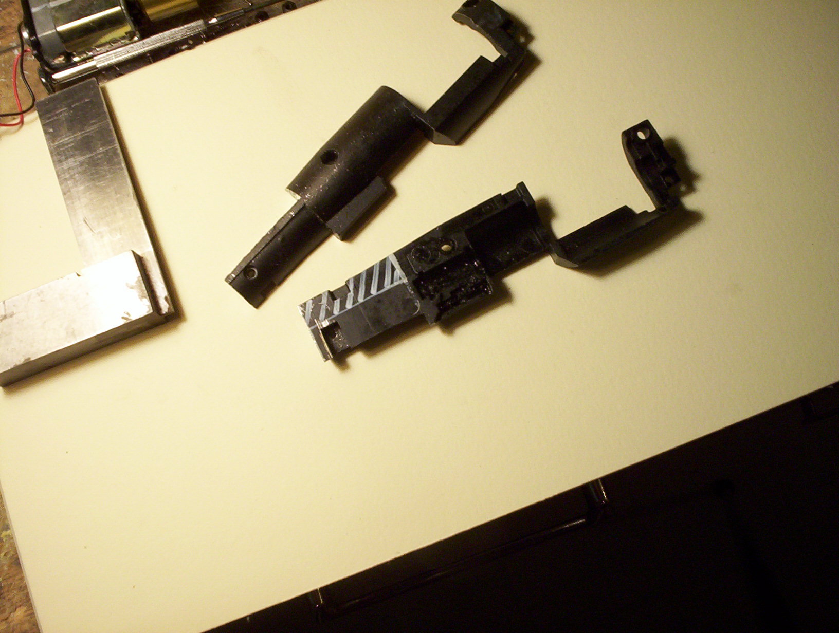

Mark the top of the motor, and note the placement of the worm bearings and the idler gearbox. Remove the motor/flywheel/worm/bearings as a unit and set aside. Remove the idler gearbox. Wipe the stripped-down weight halves of excess grease and oil.

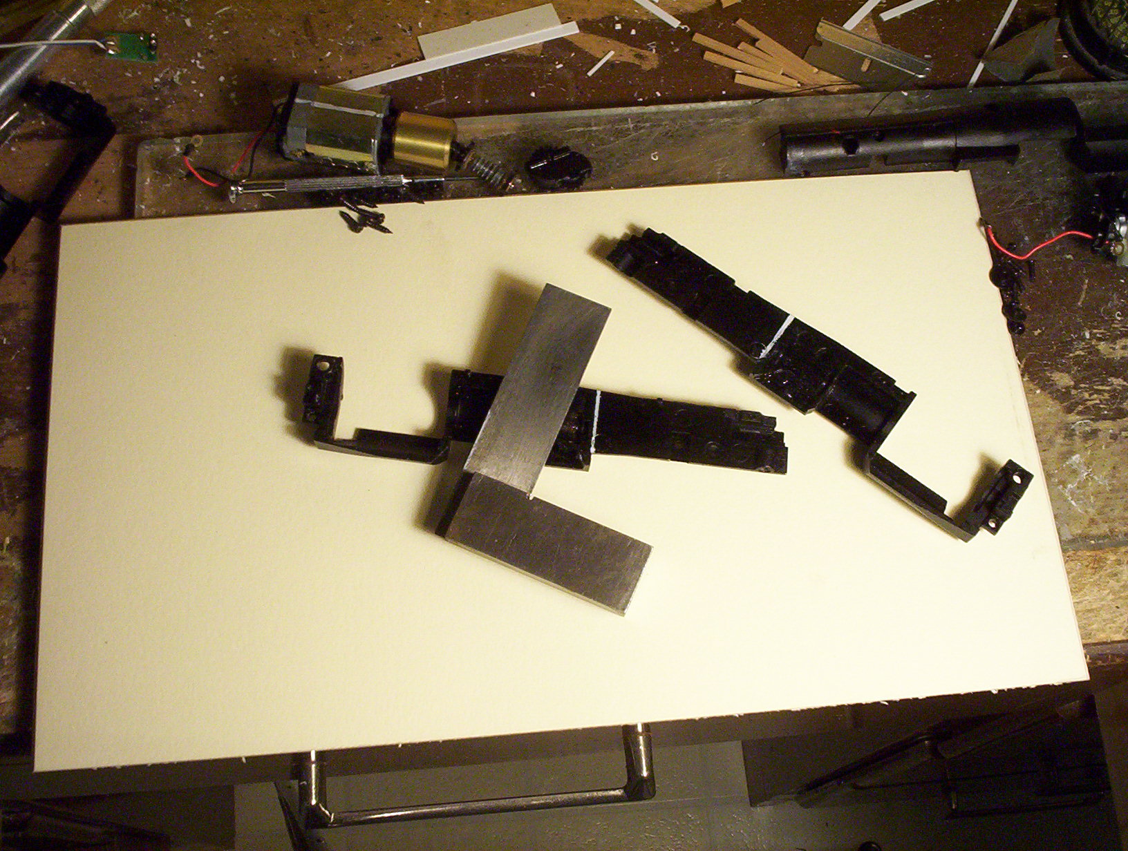

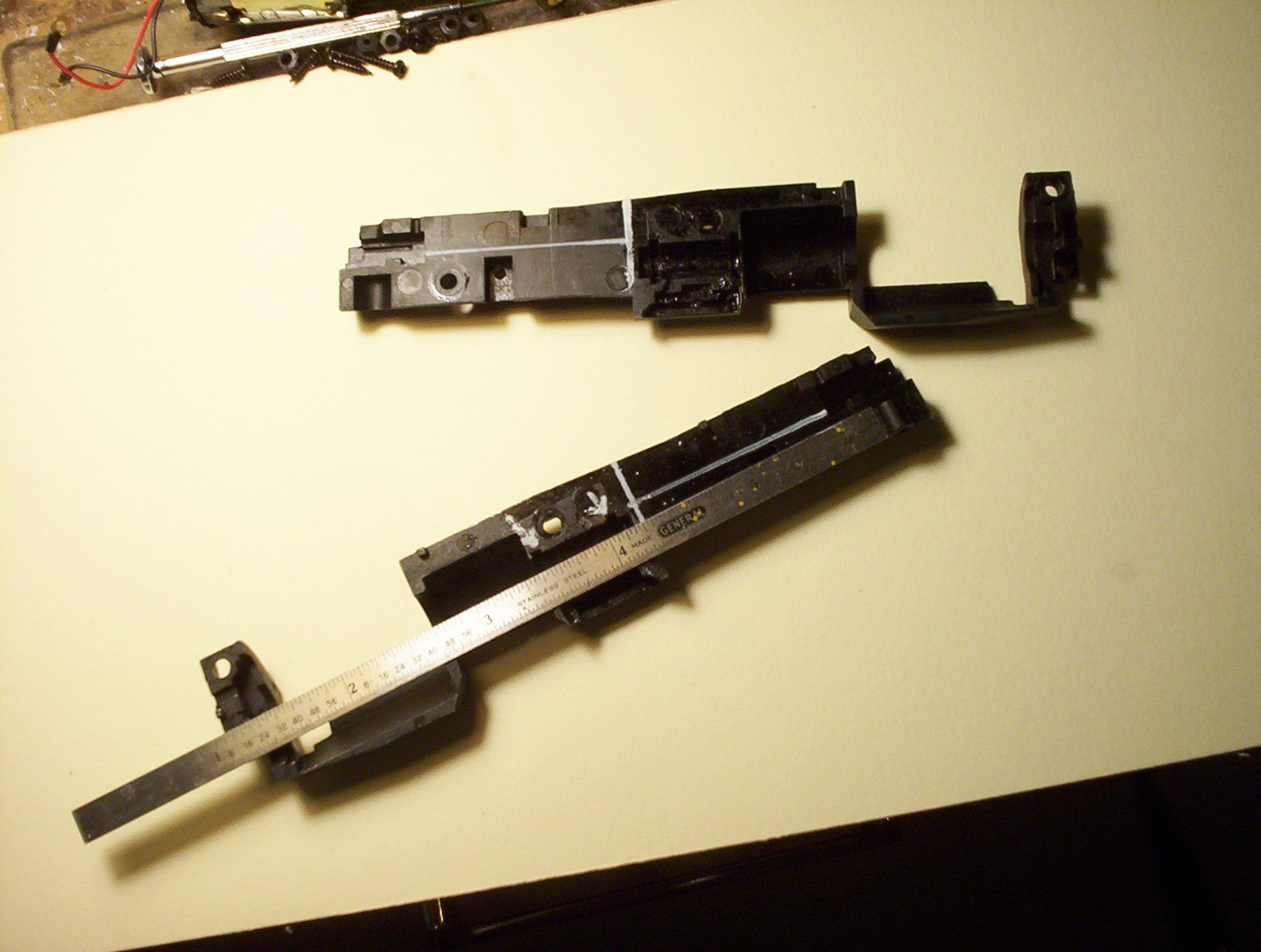

Using a suitable square, and working on the inside face of each half weight, project a line from the forward face of the gearbox protrusion up to the top edge of the weight, then carry this line onto the outer surface of the weight.
Using a suitable straightedge, line it up with the top edge of the two bearing retainer slots machined into the casting. Scribe or mark a line from the previously scribed vertical line, forward to the end of the flat surface. The arrows on the photo indicate the bearing slots.
Scribe another vertical line mid-way between the hole for the front screw/spacer/nut and the square depression machined into the bottom of the weight, which accepts the mounting protrusion that extends upward from the chassis. This line represents the first cut, which will remove the shaded area in the photo.

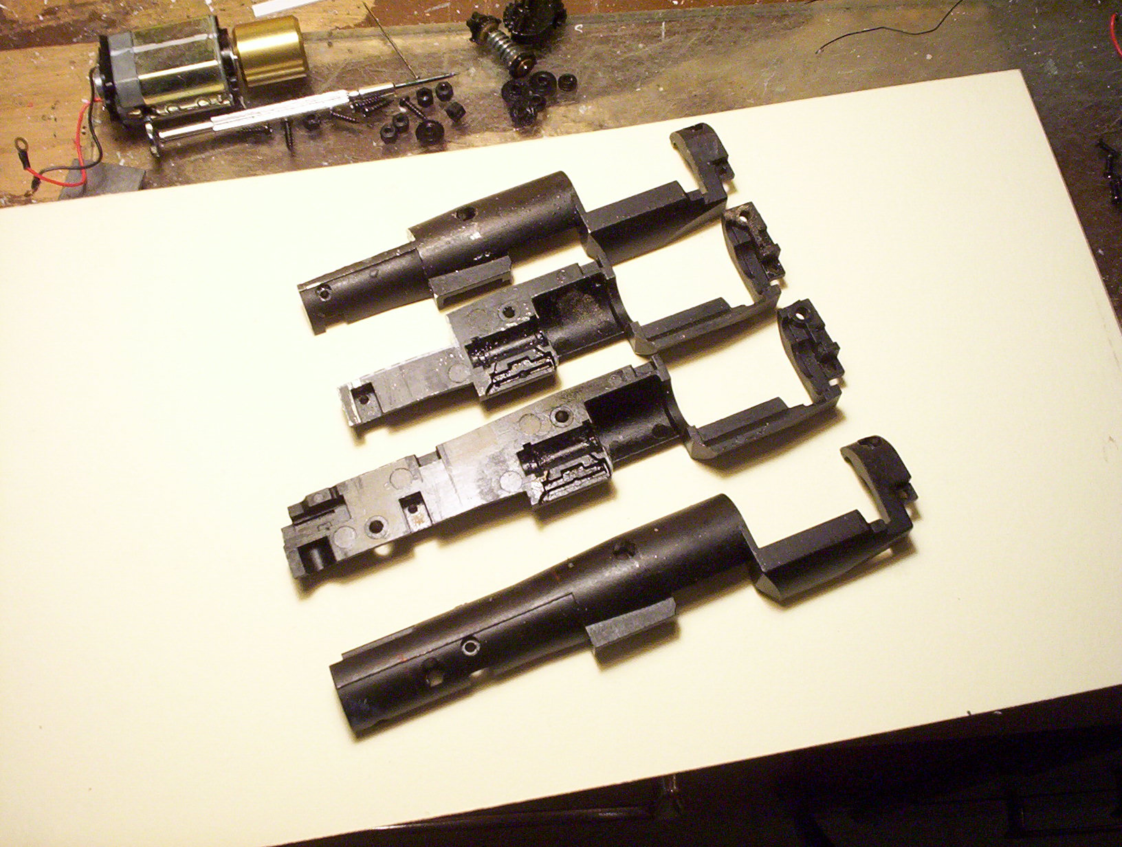

Using a hacksaw, make the first cut, removing the front of both halves of the weight. Next, cut along the two lines to remove the shaded area, then clean up all cuts with a mill file.
The next photo shows two modified halves at the top, with two unmodified half-weights below.
I removed, using the same techniques, an additional small amount from the stock weights, as shown by the shaded area.
The stripped-down stock weight weighed 5 1/4 ounces, while our cut-down version tips the scales at 3 1/2 ounces, a net loss of 1 3/4 ounces.

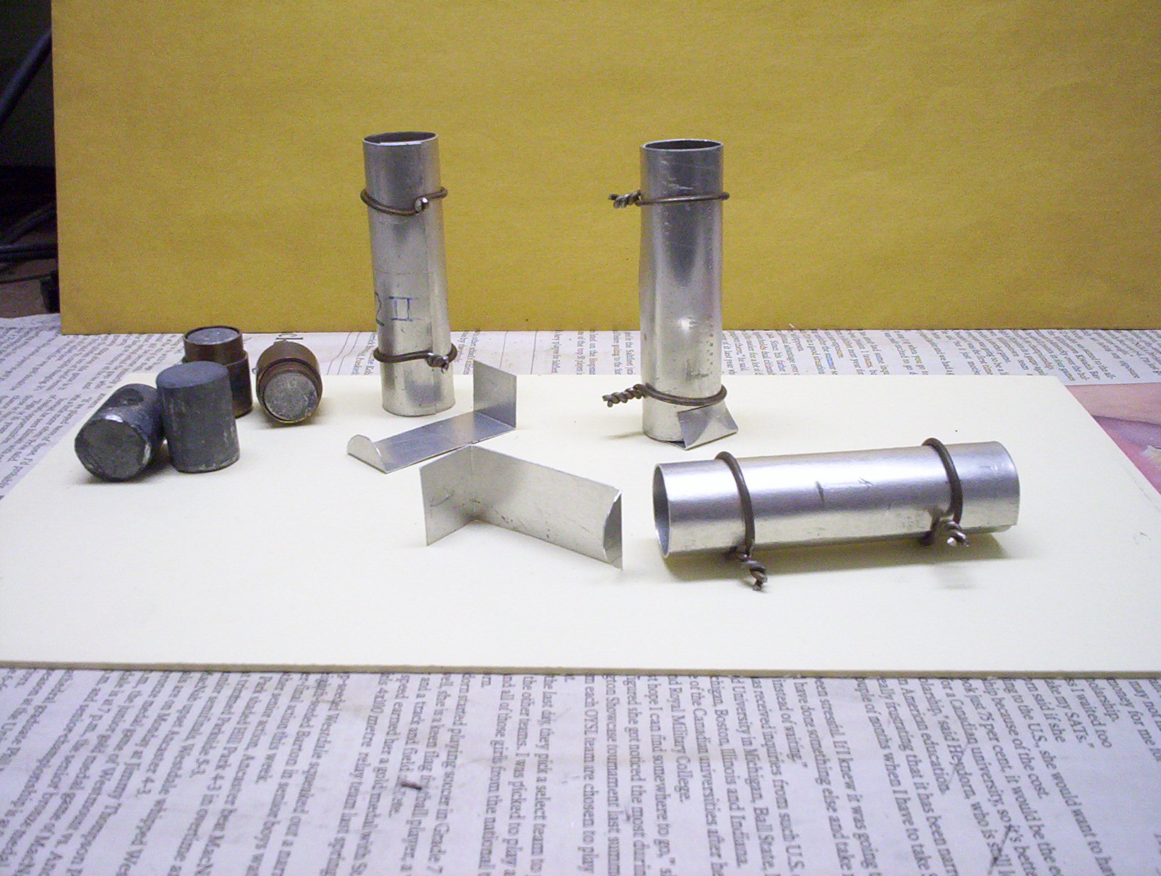

Now we need to make new weights. I use old wheel balancing weights, obtained free from a local tire shop. Using a suitable metal container and a propane torch, you can melt the wheel weights, which will allow the steel clips and dirt and impurities to float to the surface of the molten lead, where they can be removed. First though, we need to make some moulds. I used .015" sheet aluminum (scrap aluminum siding will also work: make sure that the painted side faces out).
These are simple tubes, held together with soft steel wire. The inserts (one per tube) are to provide a rough profile of the "step" required to nest this casting into the end of the modified stock casting. Cut the curved end to match the diameter of the tube: the other end is pinched over, as shown on the upright mould to the right side of the photo. To pour the weights, the moulds should be standing, as shown, on a metal sheet.
When handling the lead, do not eat, smoke, pick your nose, or in any other way ingest lead residue from your hands. Always wash your hands thoroughly after handling lead and don't leave it where children or pets can come in contact with it. I always wear a two-stage respirator when melting and pouring the lead, although workers that I spoke with at a lead casting factory assured me that no harmful fumes are released when lead reaches its melting temperature. At higher temperatures, lead vapours are released and are very harmful to breathe. (I worked in a steel mill where we occasionally rolled a grade of steel with a high lead content: breathing protection was required, as the rolling temperature was 2350 degrees Fahrenheit, and the sweetish smell of the lead vapours was everywhere).
When the lead is molten, and the impurities have been removed, gently pour it into the upright mould. I hold the mould with a pair of channel-locks to prevent tipping. Make sure that you have enough lead to fill the mould in one pour. If some slops, or if you accidently overfill the mould, don't worry: you can go back after the mould is filled and play the torch flame over the offending mess and it will soften and drop off. Make sure that the lead has cooled (this takes more than a couple of minutes) before removing the mould. The insert may need to be removed from the casting with pliers if there was leakage between it and the mould.
Now you need a coarse file to shape the rough casting: any will work, but I've found that the type used in autobody work is the fastest. Clamp the rough casting in a vise for this. You need to shape the back end of the lead so that it mates with the front end of the modified stock weight, and adjust the diameter so that the assembled pieces will fit into the plastic boiler casting. File and fit until satisfactory, then thoroughly clean the stock weights with soap and water to remove all grease, oil, and filings. Reassemble the motor/drivetrain assembly back into the modified weight, paying attention that the depressions on the edges of the plastic bearing retainers face to either side, with the protruding nubs oriented vertically, so as to be trapped between the halves of the weight. The plastic spacer with the smaller flange installs between the halves of the weight at the upper rear of the motor.
I also cast small lead weights that go on top of the frame just behind the cylinder casting and another that fits into the cylinder itself. These, as well as the large lead weight, are insulated from the frame with electrician's tape.

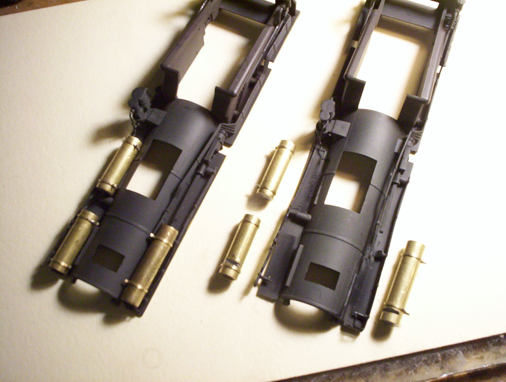

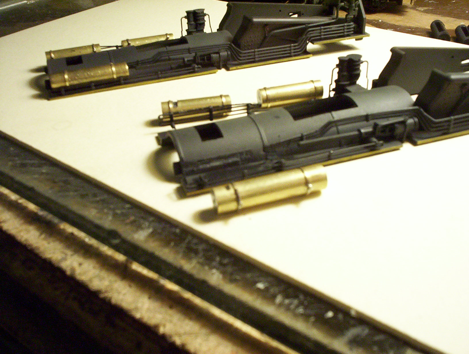

Also shown in the photo above are the new air tanks: these are pieces of brass tubing, filled with lead, and fitted with brass mounting bands.

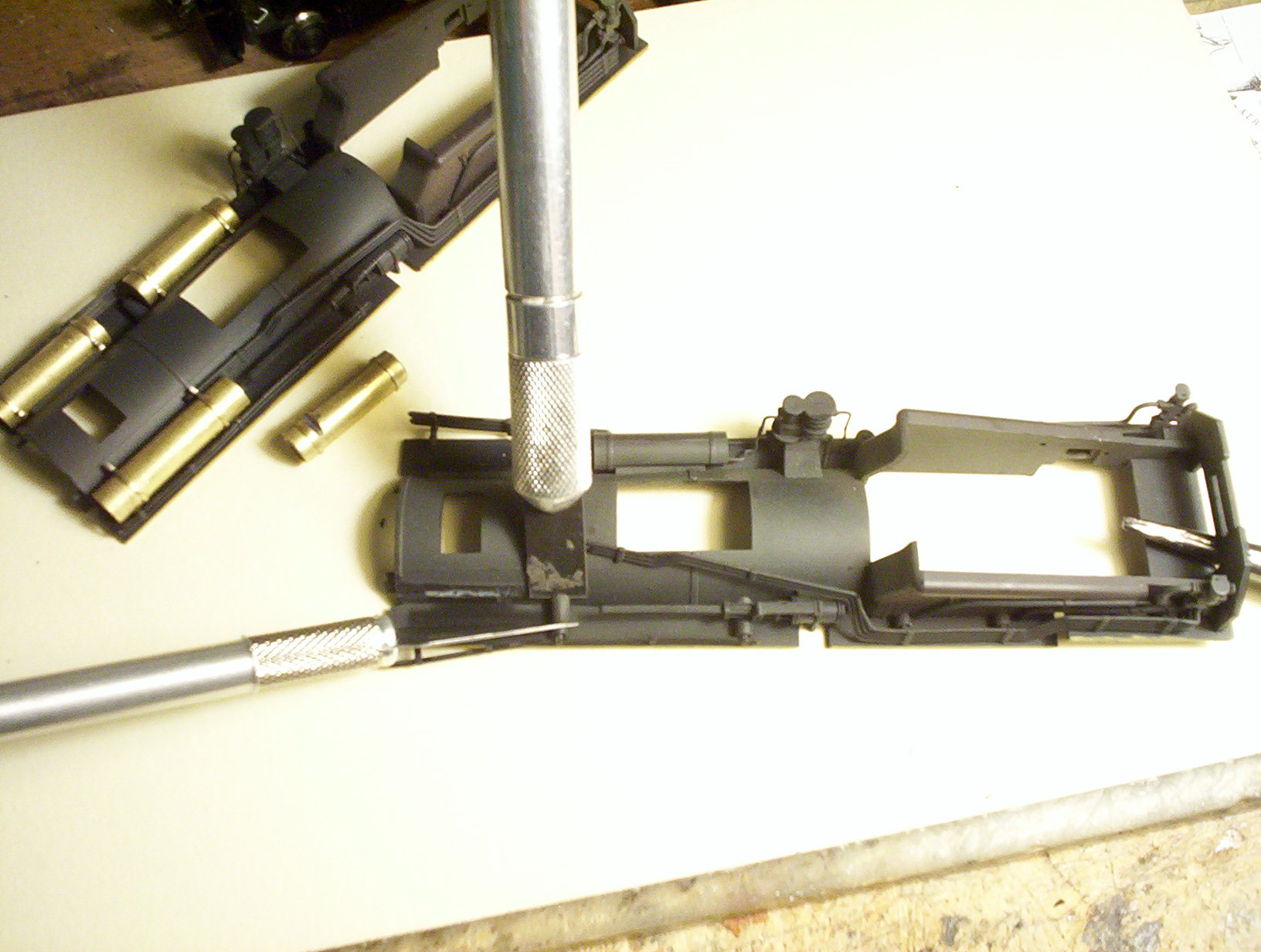

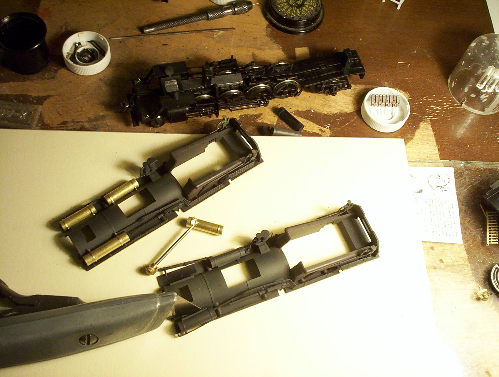

The first step is to remove the plastic air tanks. I used a utility knife for this, as the mounting lugs cast onto the boiler shell are fairly heavy.
Next, we need to remove the cooling coils, complete with their mounting pins, from the air tanks. Some of the ones on my locos simply pulled out, while others required that the tank be carved away from them. This photo doesn't show it very clearly, but the knife is used to remove a wedge of material from the air tank, with the mounting pin in its middle, then the excess material is trimmed away from the pin.
Some of the cooling coil mounting pins fit into bosses cast on the underside of the running boards. We need to remove part of these in order for the new air tanks to sit snug against the underside of the running boards and we also need to retain part of these bosses for re-attaching the cooling coils. In the photo below, the chisel blade is cutting down along the curve of the boiler, while the other blade is cutting on an angle towards it. The piece between the two blades is to be removed, then the back end of the remaining piece carefully trimmed until the new air tank will lie flat on the underside of the running board.
Below is a view of the new air tanks, ready for installation. I used brass wire, inserted into holes drilled in the back of the tanks, as mounting pins, pushed into appropriate holes drilled in the boiler, along with some epoxy where the running board meets the boiler. The slots, cut into the two front air tanks (using a cut-off disc in a Dremel tool), are for the cooling coil mounting pins that were cut free from the tanks earlier. The mounting boss that was trimmed in the previous step can be seen, in the second photo below, to the left of the brass tank on the right: the mounting pin of the cooling coil will be epoxied into it.
The balance of the loco work involves reassembly and, if you wish, detailing, paint, etc. I also modified the tenders to pick up current, using trucks from the Bachmann Consolidation. To use these trucks, the mounting bolsters on the Athearn tender need to be cut down enough so that proper coupler height is maintained. I set mine up so that the rear truck picks up from the right rail and feeds to the right (Red) terminal on the motor, while the front truck picks up from the left rail and feeds to the left (Black) terminal on the motor. If you've retained the pigtail and circuit board, you'll need to figure out where to connect the wires, which may make separation of the tender from the loco difficult. I used a two conductor mini plug between the loco and tender, which works well for my unlit, DC powered locos.
